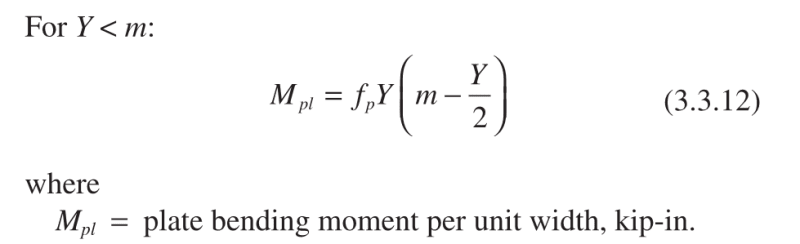

Dear colleagues,
I am reviewing a published document about Base Plate Connection design by AISC, the URL of the document is below
I have a question regarding equation 3.3.12 on page 24, I personally think it is a typo:
in that equation, fp(max) is used for case Y < m. Should it be fp instead?
if it is true that fp(max) should be used in that equation, why fp(max) is not used in equations 3.3.15(a) and 3.3.15(b) on page 25?
Thank you and I am looking forward to your opinions.

AISC has an erratta page on its website under publications for the Design Guides. You are talking about Design Guide No 1, 2nd Edition, Design of Base Plates, aren't you.

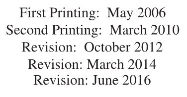

Your linked copy of DG1-2nd Edition is dated "First Printing May 2006", and it contains the error you identified.
The latest 2nd edition printing is June 2016:
And it is corrected, as follows:
==> FYI - AISC publish known publication revisions and errata here: Link
Dear jimstructures and Ingenuity,
Thank you very much for this information. This has caused me trouble the last couple of days and thank you for providing me with the definite answer!
