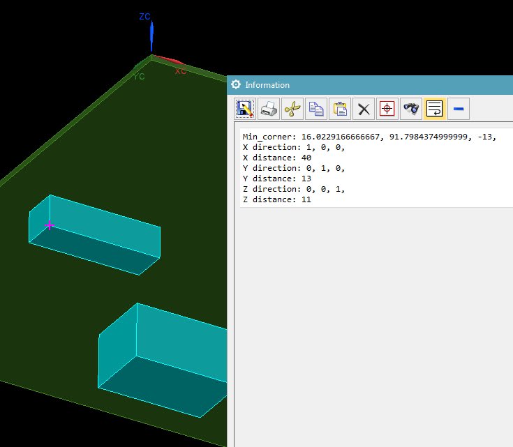

Hi
As the picture show the
min_corner that not the closest to the ABS Csys.
Or I don't understand the therm minimum corner ?
Thanks.
I used this journal for this minimum corner.

Hi Cowski and thank you.
My question is why in the peace part
always I get the magenta point
on the middle of the top face of the
block that I select for bbox.
but in the assembly part its not.
note that the selected block is an occurrence as required by the bbox function.
Clarification.
My target is that the wrapped block
to be the same as the block I select.
Briefly I need a point on the middle
of the face of the original block.
Actually I don't need the wrapped block
to be created only the magenta point
to be created.

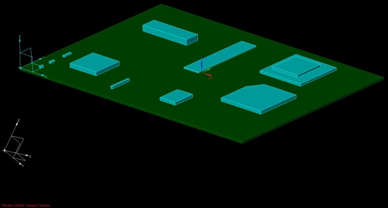

I forgot to say that befor runing the journal I set the WCS as
in this picture
