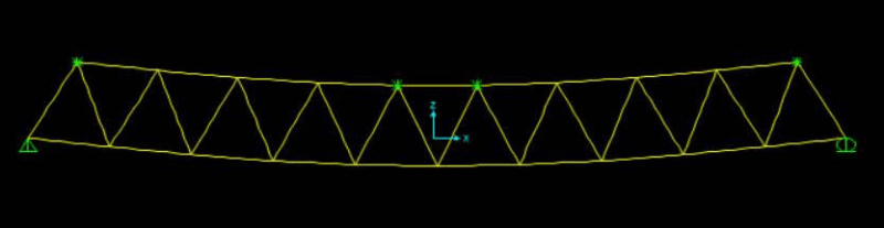

I built the model shown below in SAP2000 and ran a Linear and Non-Linear analysis.
The P-Big Delta amplification existing, but it was very low.... on the order of 0.05%. Then it increased to .13% when I increased the load by a factor of 5.

Before I finish the 3D truss example, I went through and re-read that old thread and some extra thoughts came to mind related to the 2D truss example.
I already mentioned this, but thought I should elaborate about geometric differences between top and bottom chord. This could be:
a) Different member sizes or lengths.
b) Even with the same member size, the TauB could be different due to tension vs compression.
c) In my 2D truss above, the nodes are offset. Meaning the axial forces won't quite match. If the chords were totally symmetric, with the same lengths and X bracing between them, I don't think the P-Big Delta effect would occur.
d) My model isn't the best example since I applied a distributed load to the top chord. That alone causes a geometric difference in the top and bottom chords. In order to perfectly test what KootK's talking about, I would have had to apply the loads at the panel joints of the truss.
So, even though the P-Big Delta effects are small, I believe I could get them to go down further if I was really, really careful with the geometric differences and the loading.

Okay, now the 3D truss similar to the 2D truss, but with 2 top chords and a single bottom chord. Gravity load puts BOTH top chords in compression. So, if I apply a lateral notional load to the top chords. They're still both in compression (because gravity force is dominant), but one has a little more and one has a little less. This is akin to the portal frame where both columns are in compression due to gravity load, but the amount of compression is unequal due to the lateral load. Maybe a braced frame would be a more accurate example since we have the top chords trussed together with diagonals.
Now, P-Big Delta effects on these top chords tend to amplify any sideways deflection due to the notional load. And, the bottom / tension chord doesn't really come into play since it's not really deflecting in the lateral direction. So, it's not really providing much stiffening.
This bears out in the FEM model as well where I was seeing something like a 0.7% amplification due to P-Big Delta. Now, in both cases (2D and 3D), I was using what I thought was a reasonably flimsy chord. So, your intuition is pretty good..... P-Big Delta effect is not very significant at reasonable force levels. It exists, like it would exist in braced frame structures, but it is reasonably low.
Now, my chords were pretty flimsy. So, I imagine they would fail a code check based on using an unbraced length between panel points. And, would get killed by a P-little delta analysis.
