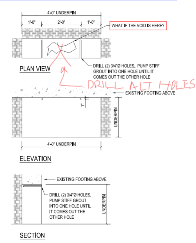

The underpinning contractor installed 14 pits so far. The inspector just now told me that the contractor is not leaving room for drypack. The contractor is trying to do avoid this step. Should I make him sawcut the top 2 inches of the underpinned pier in order to drypack it?
Ben29, in your sketch's plan view, I would not expect a void like you show to cause a problem. There should be plenty of bearing area between the footing and the underpinning. I would not expect the bearing of the existing footing to cause more than about 20 to 40 psi (about 3000 to 6000 psf) bearing - very low for concrete compression stress. Even if you discount half of the bearing area due to a possible void, you may be talking 40 to 80 psi (6000 to 12000 psf) bearing on concrete. A small void probably will not matter. If a big void is present, the odds are the drill holes will find it.
EDIT: The entire, top surface of the underpinning pier should be leveled off using a flat 2x4 so that you know there is at least 1.5 inches available to ram in the drypack. Ideally, there should be a 2.5 to 3 inch, or more, gap between the top of the underpinning pier concrete and the entire bottom of the existing foundation being underpinned. Pouring the underpinning concrete up against the bottom of the footing, even with some extra head, MIGHT provide full and proper bearing but also MIGHT NOT and is also hard to confirm.
bookowski, I have designed underpinning in NYC where everyone, especially DOB, expects to see shims, wedges, permanent jacks, etc. It is my experience that shims, wedges, jacks, etc. are rarely, if ever, needed. Proper dry packing will evenly transfer and distribute the building load to the underpinning. Wedges, shims, and jacking can cause high, possibly damaging, load concentrations on the existing footing, especially if it is a rubble stone foundation wall. NYC DOB has previously questioned me about my non-specification of wedges and shims and has accepted my explanations. (Of course, I probably just jinxed myself for my next underpinning project.) My clients and I have designed and built underpinning projects in many different northeast and mid-Atlantic states and have never used wedges, shims, or jacks unless needed to temporarily support some loose stones in a foundation wall until the pier is ready to be dry packed.
PEinc: So I can essentially issue the details that I sketched above and be done with it? You wouldn't suggest that I tweak anything about these details?

Unless 2 or more drill holes hit the same void or intersect each other, you will not get grout flowing into one hole to come out of another hole. I would also drill the probe holes tangent to the bottom of the existing footing, not 1 inch down.

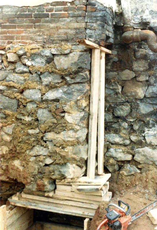

Yes, I agree that's an ugly foundation (and pretty sketchy shoring to boot). Jacking should not be adding any load to the building, it should be attempting to creep up to what was already there. For that particular picture (without knowing much) I would've expected that the rubble wall be repaired and stabilized first, that corner piece stitched into the wall such that it can be safely assumed to cantilever (which it appears to be already) doing, and then the rubble wall underpinned and jacked/wedged if determined necessary. No new load would be added, if anything the intent is to more gently transfer loads. This looks like a semi diy level operation with a guy jamming timbers in various places under a very precarious foundation. If anything I'd think that such a situation requires a higher level of care not less.
bookowski, I do not think that you are questioning my experience. Sorry if you got that impression.
With respect to the photo I posted, when my crew got on site and saw this foundation, they quickly set the approach pit ring boards, blocked up the loose stones and, shortly thereafter, mortared up the loose stones before proceeding with the pit excavation. My point for showing YOU the photo is not that it is a reference for not shimming, wedging, or jacking' but, rather, that not all walls are in good enough condition or are not uniform enough to "survive" shimming, wedging and, jacking. Should my crew have mortared that particular wall before trying to install a couple approach pit ring boards? Of course, but that didn't happen as soon as it should have and everything did work out all right. The building was not damaged, did not settle, and nobody got hurt.
As I said before, if you want to shim, wedge, and/or pre-jack the foundation wall before installing grout or drypack, go for it. I'm just saying that this isn't always needed or required, is definitely more expensive, could possibly damage a bad foundation wall and, while mentioned in various underpinning references, it is neither the only published method not the most commonly used method for transferring a building load to the underpinning.
