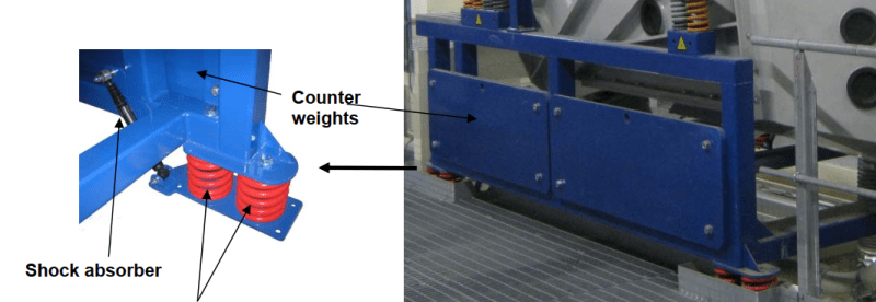

About half a decade ago this equipment manufacturer used to offer an add on kit that that was springs/weights and shock absorbers. (SHOWN BELOW) But now I believe their current kit offering is just weights and spring isolators. For the reasons you mention it was likely recognised that shock absorbers weren't really needed.
Anyway.... That is probably me done here. I hope the OP's installation goes well.
