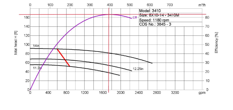

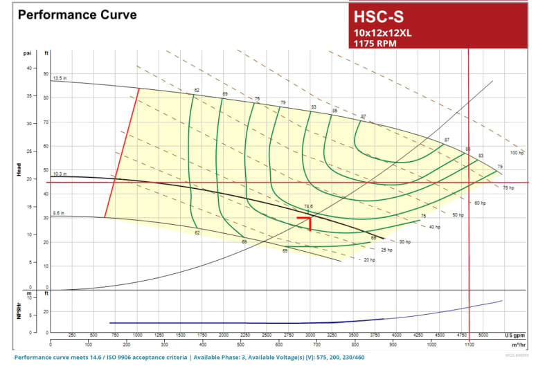

Hi All,
I want to tabulate the pump efficiency vs. flow rate for a pump that I am doing power requirement calculation. As you can see in the attached pump curve, the efficiency curves are the looping curve extending over a range of flow rates. I want to tabulate the pump efficiency vs. flow rate and use this table to accurately calculate the pump shaft power and the full load amps for the motor. I looking to get a parabolic curve with the maximum pump efficiency at a certain flow rate. How do I do that?. Can I ask the pump manufacturer?. Does the pump efficiency vary with impeller size and RPM?.
Also does the pump efficiency change with the system resistance. in my case the duty point is at 3046 gpm at 75 ft head. From the pump curve the pump efficiency is 83%. Now if I lower the system resistance by increasing the discharge line size from 10" to 12" the head developed reduces the duty point moves to the right. Depending on where the duty point the pump efficiency could either increase or decrease. I will calculate the duty point for this scenario shortly.

I have another question. So far a pump that is spare( North Tepid Pump) to this pump under question( South Tepid Pump the vendor gave me the efficiency vs. flow rate curve that is attached. This is the typical inverse parabolic curve I expected as opposed to the iso-efficiency curves given for the South Tepid Pump. My question is that why don't the vendors always give the inverse parabolic curves and instead give the iso-efficiency curves which are harder to digitalize and use in automated spreadsheet calculations. What are the differences between the two. I was told earlier in this thread the efficiency varies the pump impeller diameter, head. Here ( for the inverse parabolic curve) the efficiency varies with only flow rate. Need better understanding.

Hi Pavan Kumar,
The North Tepid pump curve shows the efficiency curve for a 12.25 inch impeller only, where as the graph for South Tepid Pump shows iso efficiency lines in the head - flow field for all impeller diameters.
If you would draw the 12.25 inch impeller head - flow curve in the South Tepid Pump curve, you could read efficiency values per flow rate there from the drawn curve.
The Pump Vendor would gladly provide you desired pump curve, though it will be indicative, as only the test curve gives final data.

Hi Pavan Kumar,
Correct,the Vendor can provide you the indicative efficiency curve for each impeller diameter.
With the selection software of most larger pump manufacturers one can select also the diameter and get the indicative pump curve. I do not remember for sure, whether this also shows the efficiency curve with the Goulds selection software.
Just ask your Vendor or the local pump representative.
