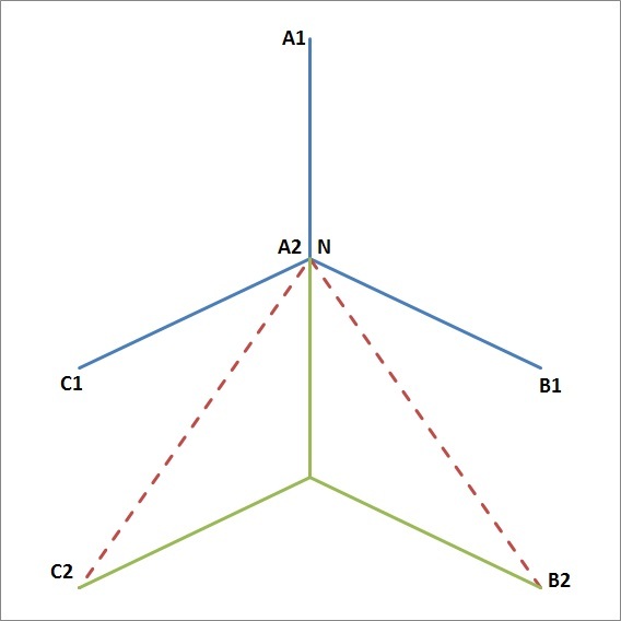

Hi
I have come across a 11kV VT which has one 33kV primary winding, one three-phase secondary winding and one delta winding. Ratios are given as [11kV/SQRT(3)]:[110V/SQRT(3)]: [110V/3].
I am comfortable with the ratios of the three-phase windings being [11kV/SQRT(3)]:[110V/SQRT(3)] which boils down to 100:1.
But I cannot understand where the 110V/3 comes from for the delta winding. The way I see it the open-delta voltage is the sum of the 3 phase voltages, VA + VB + VC = 3V0 = 0 with a healthy system. With a fully blown EF (say on A phase), VA is missing and so output is VA. This would be 63.5V and the primary side on the A-phase is 33kV/SQRT(3) which leads to 100:1 again? So why 110V/3?
Thanks.

You've missed the change of angle that occurs due to the fault.
Refer to the below diagram of the primary voltages. The blue line is pre-fault system, the green line is the post-fault system (fault is A-phase to earth).
Before the fault, the angle between VB1-N and VC1-N is clearly 120°, and the magnitude (not drawn) is 6.35 kV.
When the fault occurs, VA moves to N, so VB and VC also shift to compensate, which is why VB-N and VC-N magnitudes are now 11 kV. It should be visually apparent that the angle between VB2-N and VC2-N (both shown as dashed red lines) is a lot more acute than previously - if you do the trig, it is now 60°. This same change in angle occurs in the secondary as well, hence why we are adding two voltages that are 60° apart, not 120°, giving an "extra" factor of √3, hence why the veritas's VT has a ratio of 6350:36.7 not 6350:63.5 on the broken delta-connected winding.
I stand corrected. Thank you for the clear explanation.

The vector diagram posted by mgtrp actually nicely illustrates the "neutral inversion" that occurs. When the EF occurs on an impedance system the potential of the neutral point actually goes negative w.r.t. ground.
I think this an excellent thread and a good refresher if nothing else. I would like to thank all respondents.
Regards.
Looking at the vector drawing, A1, B1, C1, N; A line to ground fault on A1 will shorten the vector A1-N. A1 will approach N. If there is no interaction between the phases, N will not go negative. A zero impedance fault will result in A1 meeting N.
As mgtrp pointed out, The connection of the PTs is C1-A1-B1. As a fault on A1 brings A1 towards N, the phase angles of the PTs approach C1-N-B1
