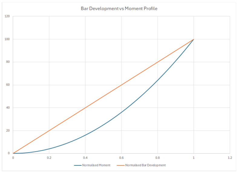

Then you look at the moment profile vs development profile
My memory is hazy on bar development but I think it would either be a relatively linear stress development or clustered at one end
In the case of a hook, it's pretty obvious that most of the development is clustered at one end
How does that help us? Well, if we need to develop 100% FRACTURE capacity at a distance of say 1m (to keep it simple) and the moment profile is linear, parabolic, or higher order, then a development length that is linear or clustered at the low-moment end will outpace the force demands of the moment
So by the point of bar yield you will have more than enough capacity
As I typed that I realised a picture would help... here's what I'm picturing in very general terms

And yes, your graph is matching my reading which indicates that flexural strength is linearly proportional to development length. In other words, Mn goes from 0 to Mn linearly over a length of ld.
My problem is I’m questioning how you square this with a tension controlled section. The relationship would indicate the bars can only yield once they’re fully developed, and yet we see in my example that the bars have to yield in a spot where they aren’t fully developed in order for the tension-controlled assumption to hold true.

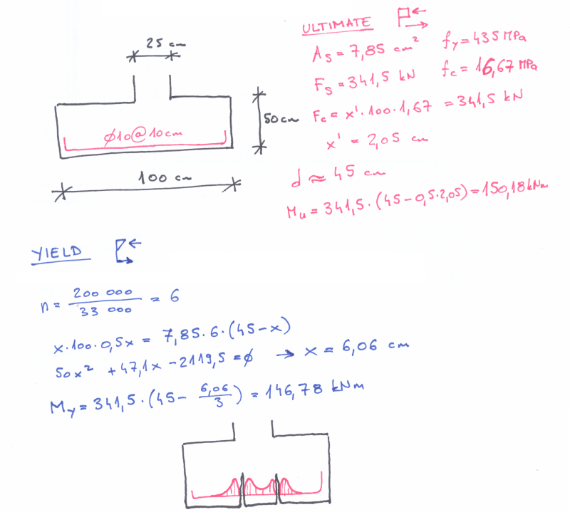

Just to show this here's a quick example of a footing. The difference between My and Mu is 2 % in this case. Also note at the bottom how bond stresses change. Most of the bond is achieved closest to the crack so if you have 5 cm less bond length at the far end because of yield penetration you'll lose much less than 5 cm / bond length because you're removing length from the least stressed part.

EDIT: For this example above, at failure load which is very high, yield has penetrated 1 cm away from critical sections (I calculated it with the assumption that stresses in the soil are constant), practically nothing.

Thanks for showing that example hardbutmild. That confirms my understanding that ultimate moment is higher than yield moment but not much higher. I wonder if there was a generic way to prove that is always true. That would put this to bed in my mind.

Do it for minimum reinforcement (like my example) and for maximum reinforcement. Anything in between should work if you can prove that it's true for those extremes.
