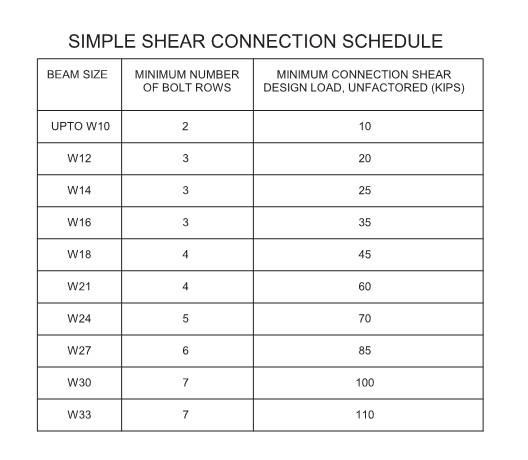

Guys, below are the table which I got from typical detail.
Thanks in advance!!

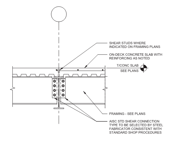

And this is for the beam to beam connection detail.
Thanks in advance!!
If, Loads are unfactored which does not mean ASD?
Thanks in advance!!
If I had to assume, I would say yes.
Fortunately, we don't have to assume. Send an RFI! Call the EOR on the phone and say "Hey - I noticed you listed the reactions as "unfactored". That means you want the connections designed for ASD, right? Yes? Thanks. Thought so. A formal RFI is being routed your way to confirm. Thanks." Or, if they say No, ask them for a breakdown of unfactored loads OR worst load combination factored reactions. Once you have it, send it back to them in a formal RFI starting with "Per our phone conversation of <DATE>, beam connections are to be designed...."
