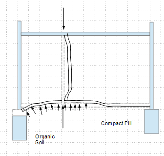

Hello,
I am working with a warranty department for a major home builder. A residence that took occupancy last year is a large three story residence with a slab on grade and turndowns around the perimeter. The lot was a cut lot and the slab bears fully on residual soil. We had no involvement with the initial site testing and I have a one pager that says it’s good. Well I’m questioning that entirely because the house has thousands of nail pops, drywall separations, molding separations, and they increase in numbers daily. A brand new house should not do this! Across the street is another development being cleared and grubbed immediately adjacent, and goes for probably about a mile. I had HABs conducted and found extremely soft blow counts, from 1 to 4 on the front left side but as you went to the rear left side, the counts were mostly acceptable >8. Lab testing indicated mostly ML, MH, and SM. All samples were damp or wet with no groundwater table found at 10’. Organics are present in some samples that haven’t been tested yet. It has been a rather wetter season lately so I suspect that’s why the moisture is retaining. I am at a loss of what could truly be causing this. There was information on the subdivision geotech report stating two lots over was a large organics pit that required soil remediation, but that was a fill lot anyways. I did a quick perimeter check to see if I could see any drainage issues or cracks in the slab but it was pouring rain so it was a rushed effort and I was sans umbrella. I couldn’t see the interior slab because of the floor coverings but I would have expected to see something somewhere in the floor tiles if there was differential settlement occurring. Only in the vertically mounted tiles did I see any separation.
Here is a sample picture of the stairs to the next floor up. The blue painters tape are where the homeowner has marked all the spots that have pops, pulls, separations, etc. The landing in the photo is one of two bouncy areas with excessive deflection.
The warranty department made repairs once already this past winter and within a week they all started coming back! So they stopped all repairs until we can fix the source of the issue causing the distress.
Here’s the big question. How do I fix this? I really don’t want to have to bring a drill out and do SPTs but if that’s the only option, then that’s gonna have to be what happens.
Has anyone ever experienced issues like this? If so, what was the issue and fix?

I am now about 99% certain there’s a moisture issue AND an organics issue on the left side. We found organics down to 10’ in two holes below BOF. Another random find, there’s pyrite in the soil too.

This is a cut lot so no fill. So far, I don’t have any reports of different settlement or bulging in the first floor. I do plan to check the levelness in various areas to confirm if things are level or bowing.

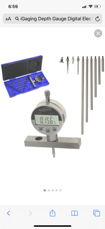

Found it. All we need to do is search for "depth gauge", dial indicator. Penn Tool Co sells what looks oK ,maybe needing interchangeable tips for length variations.
That definitely seems like an easy enough way to measure the studs. We’ve got a couple of different tools available I just need to go thru and see what would work best. I know we’ve got calipers, I’m just not sure if we have dial indicators like your sketch but I’ll just expense it and go to the hardware store if need be. I was thinking about the plate concept you mentioned and also looked for literature about it, but didn’t find anything either. However, I do believe I could get some shim packs, measure them, and place them on some of the studs as well. Then set an interval to verify any movement or change in orientation.

Something like this looks like it would do the trick! Thank you!!

Damn fancy and costly. But likely will work great. Might be possible to avoid a reference rod in a hole, if the bottom of a drilled hole can be solid as with a screw there. The one I mentioned is darn cheap however.
Edit: remember to avoid also measuring wall board as with a solid pipe or other is needed at the opening. Or just use a plate on the wall board t monitor all the depth in as either or one is the culprit.
They’re only $70 a piece so I’d say that’s a small price to pay to get confirmation data. It likely won’t be quickly obtained but it will give results.
Fine, I've seen most gauges descriptions with added "stuff" in the hundreds. Finally remember both reference points have to be solid. The painted drywall may be ok, but if any variations happen when you take it off and replace it, they must be within one unit, hopefully. Otherwise nail something solid, even two flat head nails. Of course then your measurement wold not include the dry wall. Keep the drilled hole smallest possible diameter, then there is less likelihood to affect true conditions. I'd use several locations, outside and interior walls as well as upper floor areas. Temperature of test site should not vary. No sunshine, etc. Good luck.
