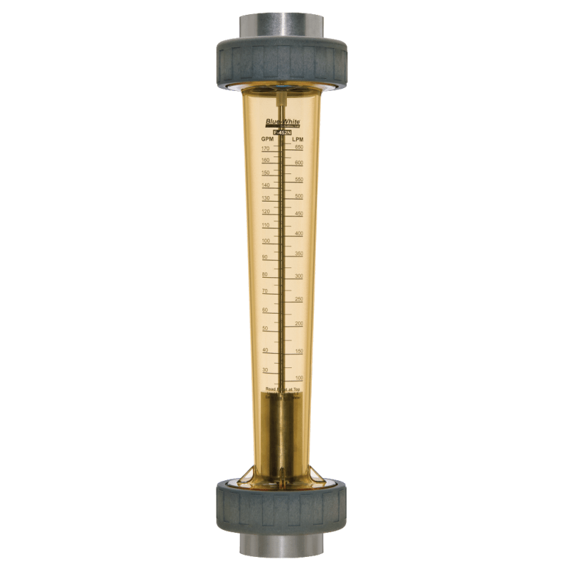

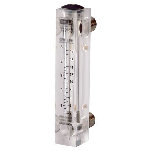

Do you mean something like this?
They state upstream and downstream configuration isn't an issue.
All the flow goes through the meter and swirl isn't really an issue for this type of meter.
Unless you mean something else?? If so please send a link or attach photo.

The control valve goes before them with liquids, after them with gasses.
Many of these can be rebuilt to change tubes, floats, and kind and location of valves.
Ultrasonic flowmeters and differential pressure types are usually very sensitive to flow disturbance, where turbine and float type meters are not.
The inlet/outlet process connections are either in-line with the tube at the top and bottom or at 90° to the tube orientation, on the backside of the tube. Sometimes there are elbows right at the inlet/outlet.
There's no reason to condition the flow with upstream or downstream straight runs when the meter's performance is not affected by it.
"There is no straight run of pipe needed. The meter can be installed immediately before and after a valve or elbow. It’s important to remember this is a measurement device and should be plumbed accordingly. It is not a good idea to install short radius reducing elbows on the inlet side as this can cause swirling."
