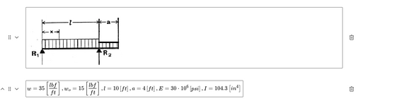

The way it does beam bending in Matlab is by repeatedly applying formulae, and then correcting them by adjustments in response to increasingly brusque corrections from the user. I did get it to simulate a bouncing ball correctly, that took 12 iterations.
but presumably having solved it once, it could solve a similar beam much more quickly. but could it solve a redundant beam any quicker ?
I can't even get it to solve the original problem, never mind a redundant beam.
Here's the problem, I won't bore you with the many iterations of a script that chatgpt created to solve it
Here's a link to the actual solved problem https://engineeringpaper.xyz/9r6KzVsGjtrKvaYWQj5dw2 and I've included a pdf of the entire thing

2ft of deflection on a 10ft span?? I have no issue with the direction of deflection, positive or negative means nothing, it's a simple sign convention, but the magnitude of deflection is tremendous, are you certain you have your unit conversions correct, or more specifically, are you certain ChatGPT has unit conversion and parsing correct?
deflection in "mills" (not ft). Moment curve looks off at the RH end (looks slightly positive when should be zero) but that may just be the plotting routine ?
Deflection +ve down (hogging is +ve) is a convention, not the common one sure but ... but shouldn't the overhang deflect down too, like the midspan ?
Yes, it doesn't go exactly to zero because the dx value was 1 inch, which is far too coarse unless you interpolate, which I didn't. You can see the lack of resolution in the SF diagram at the rh support.That's a missing area of about 1/2*247 lbf*1", about 10 lbf ft and the residual moment at x=14ft is -10.556 lbf ft
The rh end is relatively lightly loaded as can be seen from the SF diagram so the bulk of the tip deflection is due to the slope at the rh support.
I've sorted the sign conventions out. Overall I'd say it took longer to get ChatGPT to get it mostly right using FEA than if I'd done it myself, because I had to check every line and then remove a bunch of bad logic, but it did a reasonable job with the plots and I didn't need to look anything up. The biggest correction I had to make was adding the integration constant in to get 0 deflection at the RH support, a boundary condition ChatGPT blithely ignored. You can argue the toss about whether it is easier to debug a well written albeit inaccurate script vs writing it from scratch, I think the fact the the ChatGPT scripts run properly, ie without syntax errors due to missing brackets etc, from the word go is actually quite a big deal for a lousy typist like myself.
OTOH if I hadn't known about FEA as an approach then ChatGPT was leading me up the garden path using canned equations and then bodging them. So IF I know how to solve a problem then I'll get ChatGPT to rough out a script and then fine tune it myself - getting ChatGPT to fine tune things is very time consuming and ends up in repeated bad solutions.
