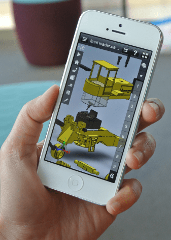

Good day everyone! Thank you for your insights in advance.
Just wondering about this behavior: Using a mobile viewer App, would you want 3D model measurements saved?
I can see arguments on both sides: [bigears]
1. Save to avoid losing user inputs.
2. Not save to avoid conflicting with the true definition because ad-hoc measurements may not 100% observe the designed dimensions, due to unskilled measuring techniques, fat fingers, and geometric tessellation. The authority should come from official drawing detailing or 3D annotations? So mobile App model measurements would be only for rough estimates, rather than accurate production, similar to tape measuring a physical piston rod or an engine. A machine shop wouldn't machine a rod simply per 3D model measurements, would they?
What about measurements on 2D drawings using a phone? Save them or not?
Thanks!
-Ryan

Oh and regarding machining or fabrication. I wouldn't even trust many computer 3D models for information regarding machining. As not all detail may be included. Tolerances, finishes, welds etc are not always included in a 3D model. Though with rigour modelling then maybe you could get to a state where you could trust the 3D model.
assembly can sometimes be suitable off a 3D model depending on the item. But a again the 3D model might not include sealants, torque requirements of bolts etc...
As I expressed earlier, in some cases we have constructed large machine support structures and their equipment purely from 3D models run off smart phones. These models are typically Autodesk Inventor or a BIM model of steelwork. We have a competent work crew and we foot the bill screw up and it needs to be fixed.
I'd send nothing to a third party that wasn't accompanied with a drawing. (profile cutting, 3D cutting model can sometimes be used, but they still have a drawing.)
I'm really confused. I was under the impression that you wanted to create something in which you "could", optionally, if you want to (user decides), save the result of one or more queries taken from the model geometry. Now I'm getting the impression that you want to "force" saving of all user queries of the model geometry as some sort of permanent record of what someone did. Un-confuse me, please!
The viewers today let you query the geometry but don't allow you to preserve it in any way. You can, of course, take a screenshot.
How we use it:
- What's roughly the height to that overhead object ... is there enough room for someone to walk underneath without banging their head?
- What's roughly the distance between the closest approach of that robot and the perimeter fence ... can someone stick their finger through that opening and get to the robot path? Does this distance mean we can use the standard 2" wire mesh, or do we have to use 1", or does it need to be a solid panel?
- Is the path of that robot end-of-arm tooling underneath the overhead mezzanine ... or is it probably going to hit?
- Is there enough clearance around that bolt for someone to get to it with normal tools?
- Do we need a step for someone to get up on that platform, or not?
That sort of thing. No great deal of precision. Tape-measure accuracy is plenty good enough for what we do with it. No need for a permanent record. I wouldn't dream of pulling dimensions requiring a toleranced fit from the model geometry, and IMO anyone who pulled a stunt like that deserves what's going to happen to them. If there is a demand to do such a thing, it means the drawing sucks because it's missing a required official dimension, and needs a proper revision to add it. (and yes, it happens. No big deal, get the drawing revised and carry on with life.)
