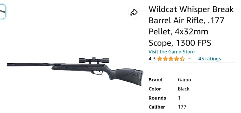

The max speed of a Pneumatic cylinder of 40mm dia (1.5") is roughly 3m/sec. No way you are going to get a speed of 250m/sec using a pneumatic cylinder. Try firing a bullet type projectile.
Look into a pellet gun construction.

Ah - Always wondered how they worked.
The alternative is of course a paintball gun pistol which uses CO2 pulses of gas.
Paintball guns and similar precharged pneumatic rifles use a bash valve, basically the trigger releases a small spring loaded weight that bumps a valve open briefly to release a small amount of high pressure air into the chamber. A third method, used for light gas guns in research (these can get up to 10 km/sec speeds) is to pressurize against a burst disc that opens at a fairly reliable high pressure.
Interesting information. Since everyone sees this as a airgun I resized my syringe and needle to be comparable to what hydtools linked to. Nice link by the way. Never seen that before.
