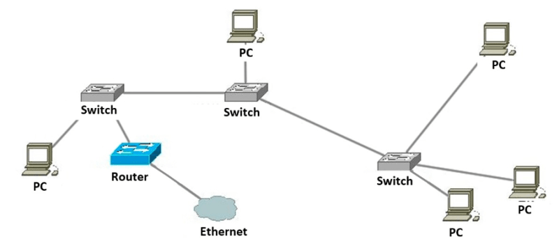

I doubt you can even buy a new Ethernet hub in 2020. They stopped making those years ago.
Ethernet hubs are not secure and will broadcast all packets to all connected devices causing lots of network congestion.
An Ethernet switch uses the host's MAC address to send the packets only to the correct devices.
I don't see any major security issues with using field installed network switches. However if one fails then you will lose all devices connected to it and it could be harder for the IT guys to troubleshoot.

Without putting too sharp a point on the stick, it seems to me that installer "experts" incorrectly feel they are experts in IT. It is a near impossibility to guarantee you're not adding another attack vector to the system when placing a WAP (of any sort) onto a LAN. Security research is one of my main fields, and to think what you're asking for is without major risk is naive, at best. Hardwired is safer by orders of magnitude.

Some might nitpick at the terminology, but the wanted functionality is available here -- inexpensively:
NETGEAR 5-Port Fast Ethernet 10/100 Unmanaged Switch (FS105NA)
Price: $21.99​
