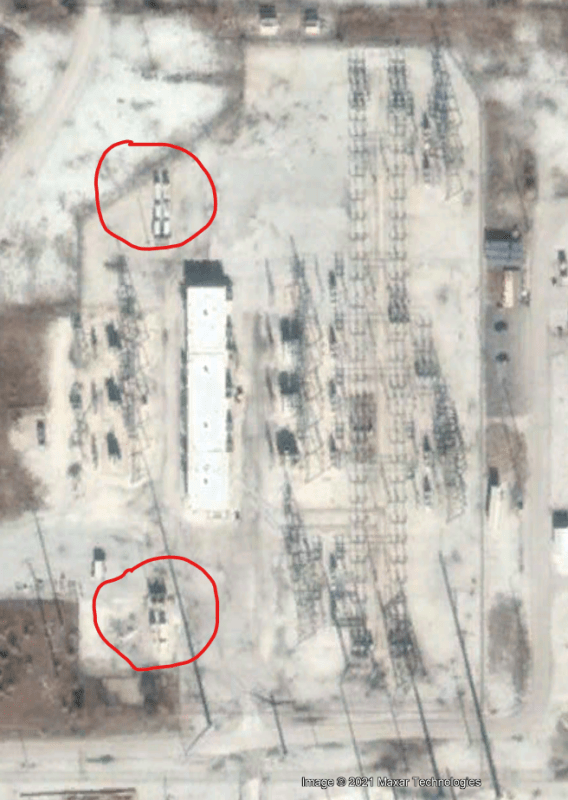

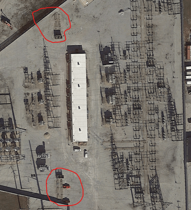

I was referring mainly to the capacitors at the station. My local Utility ComEd here in Chicago has been removing station capacitors from a number of their distribution substations. In general, I don't think they have added more capacitors in the field to their system, but they did have quite a number.
In this example, Calumet Substation, it is probably the largest distribution substation on the system. There are (4) 75MVA transformers 138-13.2kV (12.47kV system voltage). As you can see in the photo, they originally built the substation with (8) metal enclosed capacitor banks. Now they have removed all of those metal enclosed capacitor banks. I doubt they have moved this equipment inside the control house.. A quick look at the area, it looks like nearly every feeder has a capacitor bank associated with it, and I'm guessing they are each 600-1200kVAR on each bank. It is possible that their regulation has become more satisfactory due to a stiffer transmission grid which has been helped about 15 years ago by some projects that added 345kV system capacity to the area. Usually design wise you have to account for minimum voltage being 5% under nominal on the transmission side and still try and keep substation bus voltage at 100% nominal, in this case, a little over 12.5kV. This is also considering you lost a transformer and so one section of bus must carry a little more than the rated nameplate load of a transformer. I just found it interesting that in many of their distribution subs they have been removing metal enclosed banks, and thought it could be because the load power factors have been improving since the original designs in the 1970's.
Here is the substation in 2005
Here is the substation now, all metalclad banks are gone.
