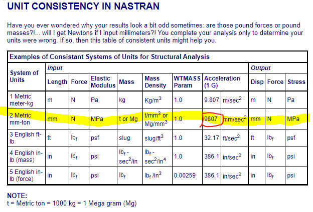

Regarding the units:
If you Google "FEMCI Book" and click "Unit consistency" you will get the table you see below. So for consistent unit you need to follow line 2.

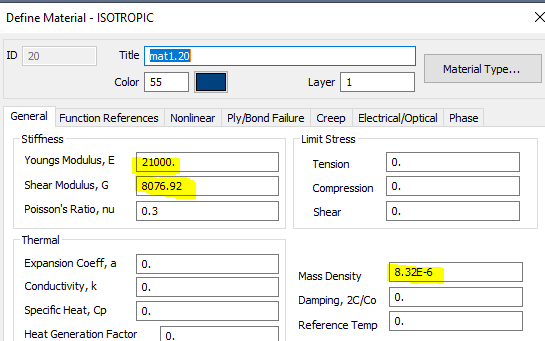

Below the table you can see the data from when I import your bdf-file into Femap. Young's modulus should be in MPa and assuming that you are working with steel that means 210 000, not 21 000. If the material isn't steel, my comment is of course wrong.
And for steel the mass is approximately 8000 kg/m^3 (7850 is probably more accurate). And converting that to tonne/mm^3 gives 7.85e-9.
Perhaps you are working with a material that is close to steel in some respects but not in others. But if it is steel I would check the numbers [smile].

May I ask what type of material it is? It seems a bit odd that it is "softer" than steel and the density is much higher.

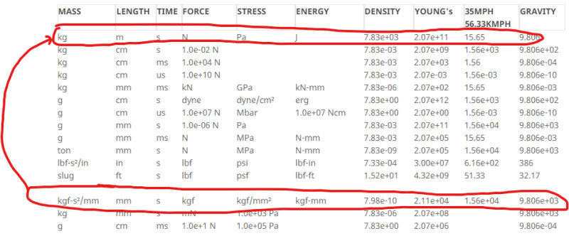

Hi all,
After rechecking with the professor, I realized that the issue was related to the unit system.
The problem was that the problem should be using the unit of kgf instead of kN, as I mentioned earlier. When I switched to kgf, the results matched. However, I still encountered the following issue:
