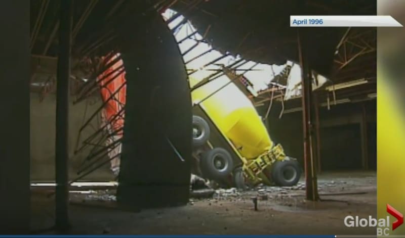

When I heard the news on the radio earlier today, that a rooftop parking structure in East Vancouver collapsed, my mind immediately went back to an incident in the mid 1990's when a loaded concrete truck punched through an elevated structure, landing on it's ass end in the business below, knocking the driver unconscious. It turns out to be the neighbouring address, however, everything about the development screams that it's the same owner development.
The earlier incident occured in part because the height limitation frame at the parking entrance had been removed to facilitate renovations. The concrete truck driver didn't get the message. I notice in Google Street View there is no equivalent warning structure at the entrance to the 3438 address. WorkSafeBC better be all over this.

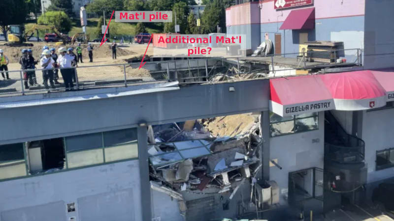

If they were re/re the roof membrane and there was a layer of sand isolating the existing membrane from the asphalt paving, it appears, they were consolidating the material for removal. The evident pile in the background is distributed across many precast concrete T-beams however, adjacent to the failed zone, there appears to be the remnants of another pile which may have run in line with the length of the T-beams.

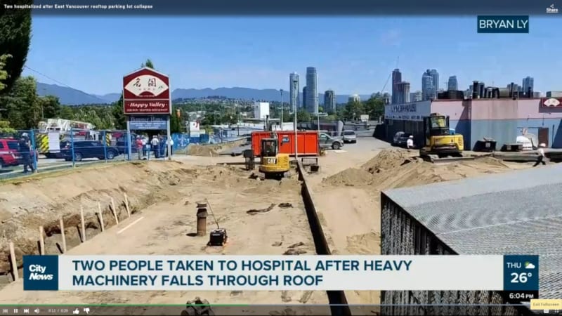

Apparently they were using the rooftop parking area to stage fill/top soil material from the rooftop green space during reroofing.
CityNews
Interesting photo, that. I was wondering how far the "building" went, out towards the road--farther than I thought. Comparing to an overhead view, it looks like it went beyond the parking area, and under the "dirt".
It will be very interesting to see how much "dirt" was piled on the area that fell. And to compare its weight with what the deck should have held. Since there doesn't look like an obviously safe place to store it on-site, moving it elsewhere would have added a lot of expense. Justifiable, obviously.

There's the skid steer and a pile of dirt.

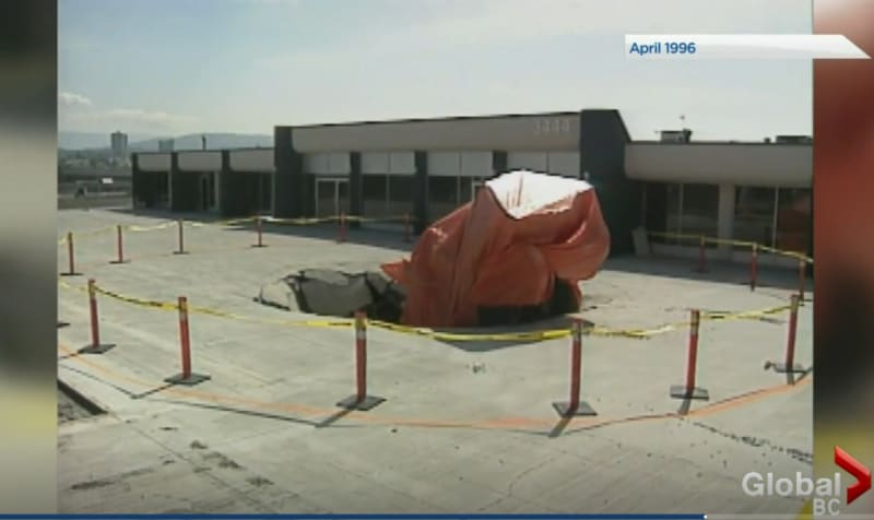

Images of the concrete truck incident from 1996. The neighboring structure is steel truss design as opposed to the precast concrete T's used in this design. It's still disturbing to see these two incidents on adjoining properties/addresses.

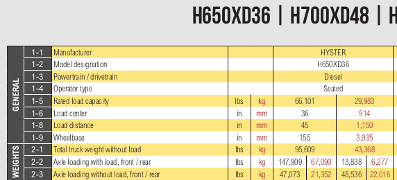

Perhaps I am a bit sensitive to the issue. When your employer has some of these monsters running around the plant you find that standard precast concrete DI structures suitable for HS20 loading have limited service life. Failure mode is the casting punches through the concrete.
Concrete mixers are not this heavy, but they also push the loading envelope.
