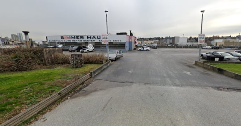

When I heard the news on the radio earlier today, that a rooftop parking structure in East Vancouver collapsed, my mind immediately went back to an incident in the mid 1990's when a loaded concrete truck punched through an elevated structure, landing on it's ass end in the business below, knocking the driver unconscious. It turns out to be the neighbouring address, however, everything about the development screams that it's the same owner development.
The earlier incident occured in part because the height limitation frame at the parking entrance had been removed to facilitate renovations. The concrete truck driver didn't get the message. I notice in Google Street View there is no equivalent warning structure at the entrance to the 3438 address. WorkSafeBC better be all over this.
Google Earth view of 3434/3438 Lougheed Hwy., Vancouver, B.C.
3434 Lougheed Hwy. - Site of Today's Incident
3438 Lougheed Hwy. - Site of Mid 1990's Incident

Apparently they were using the rooftop parking area to stage fill/top soil material from the rooftop green space during reroofing.
CityNews
Interesting photo, that. I was wondering how far the "building" went, out towards the road--farther than I thought. Comparing to an overhead view, it looks like it went beyond the parking area, and under the "dirt".
It will be very interesting to see how much "dirt" was piled on the area that fell. And to compare its weight with what the deck should have held. Since there doesn't look like an obviously safe place to store it on-site, moving it elsewhere would have added a lot of expense. Justifiable, obviously.
