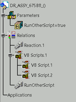

Hello colleagues! I am trying to call a VB Script with argument from another VB Script with argument. Is it possible??
Please see attached images.
Create a Product with a Reaction and 2 VB Scripts with Arguments.
Create a Part
Inside the reaction select the Product1 as Source and Insert as Event. Insert The previously created Part (Part1.2-Instance Name)
VB Script.2 will send a msg
will Call TEST(Here is where I am not sure if it is possible)
error received
The Call send the message "sdgsdgsfgsgfsag"
The goal is to have the message box showing "sdgsdgsfgsgfsag" at the end of the process.
Any reply will be much appreciated!
Thank you for your support!
Eduardo Pinto
one possible work-around (I couldn't find any direct way of accessing the scripts within the script node in CATIA tree...):
Since we know that reactions work for your case, create a parameter (its value change will trigger a reaction that calls on your second script...)
and change it's value in the first script.
to control the parameter located in the assy, use syntax similar to this:
CATIA.ActiveDocument.Product.Parameters.RootParameterSet.DirectParameters.item("RunOtherScript").Value = "True"
my RunOtherScript parameter is a Boolean
regards,
LWolf
