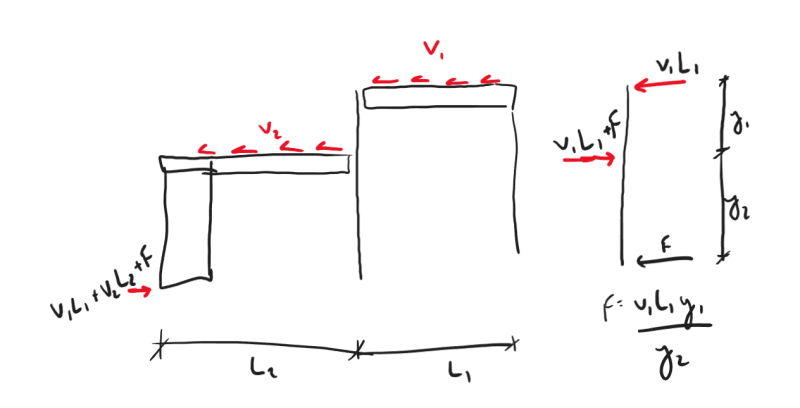

You have a beam column at the step. Attach your chord elements to the beam column with straps and through direction bearing for tension and compression loads, respectively. Draw a FBD of the beam column and you can design the beam column easily enough.
Agreed with Pham I've had to do this quite alot especially on custom homes. You want to limit lateral deflection of the beam-column because it will contribute to diaphragm deflection and its not a simple task to try to determine by how much. I suppose you could add a fixed number to the chord term of the deflection equation.
Another thought would be to try to make the chord occur at the top of the joists so that it can be continuous. Strap over blocking.
The beam column would also be part of the drag load path, its not ideal but what ya gonna do. You 2500 # isn't huge though strap over blocking could easily handle this.

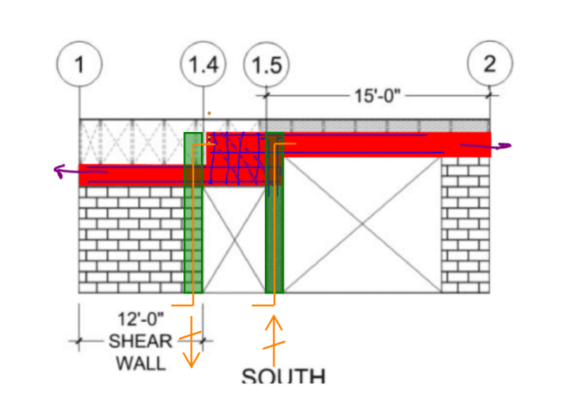

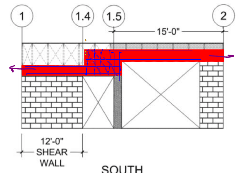

I too agree with phamENG in principle. For a high seismic situation, promoting a shear failure across a column is kind of sketchy though. Were I in a situation where I was not comfortable with that, I'd probably push for a solution like that shown below. It echoes how stepped masonry bond beams work as chords and collectors.
Good suggestion. I'll typically step a CMU bond beam over one course at a time. Say a 10ft run of T.O. 16" bond beam at +10'-0" will step down to T.O. bond beam at 9'-4" and I require that overlapping length a minimum 16". Similar with foundations, I'll step T.O. footing at 2'-0" maximum intervals over a 4ft length (combination of industry standard where I am and what I'm comfortable with). With your suggestion, stepping at 3'-0", do you have a special reinforcing pattern in mind?
No need to fix the base. The reaction at the base should be just be shear to balance the moment from the offset chords unless you want it to be a shear wall.
Something kinda like this:
Nothing too exotic. It's basically just a version of an offset lap splice. When I can get away with it, I see that as being one of the benefits of intelligent proportioning: it often obviates the need for fancy rebar detailing. Here, "fancy" probably just means some dense column ties between / through the tie beams. And some attention to overstrength and capacity design principles if it's a high seismic thing.

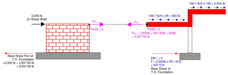

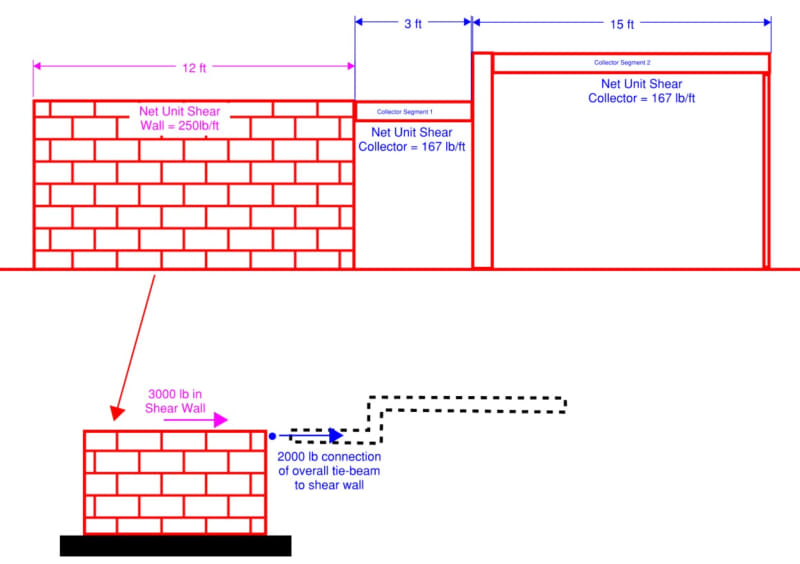

I understand the right hand side of your FBD. However, it feels to me like the overall approach is doing something strange to the unit shear in the collector. I'm trying to simplify this model by calculating it using a quasi method of sections, where the beam-column is a brace point. Bear with me as I try to explain my approach (I need a sounding board).
In the image below, I'm representing the overall lateral line comprised of a shear wall and a collector (that jogs). I've shown the net unit shear in the shear wall and the collector. Below that is an idealized model of the shear wall, which shows the overall 5K lateral load being resolved down to the foundation.
Applying your approach for the intermediate collector force at the beam-column, I get the same magnitude of force that you did.

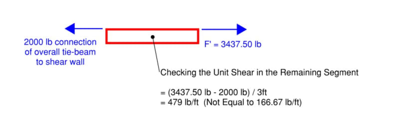

Now this is what throws me off. Using the same reactions and doing a logic check on the 3ft section of collector, I don't get a value that matches my original assumption for the net unit shear in the collector.
This throws me for a loop against any problems I've read where calculating unit shears is either a function of a collector/drag or a shear wall (never an intermediate beam-column).
I realize this: (3437.50 lb - 2000 lb - 937.50lb) / 3ft = 166.67 lb/ft
However, this would beam that I have two different unit shears in the collector and a different connection load from Collector Segment 1 to the shear wall. I'm just not too familiar with this approach. I hope I summarized where I am coming from.
I think your math is a little off at the "connection of overall tie beam". 167plf(3ft+15ft)=167*18=3006lbs, not 2000lbs. So....(3437.5-3000)/3=145plf. That's closer. BUT...your 3000lb tie force presupposes that the ONLY loads in the collector are from directly applied diaphragm shear. The offset makes that incorrect. You need an additional axial load in that 3' piece to make the couple that counters the moment induced by the offset collector.
So rather than assuming a tie force, you should apply all the loads and work back to it. I'm guessing you'll come up with 3,937.5lbs for your tie force.
phamENG,
Yeah you're right. In my OP I had 2,000lb in the wall and 3,000lb connection force (which is correct). Somehow, I flipped the two values when putting together that sketch, then (enthusiastically) ran with it.
So to clarify, diaphragm shear connection remains as 166.7lb/ft along the collector. It's just the collector to shear wall connection that needs the additional force. Thank you for illustrating this. It's interesting... I haven't really seen this described in our texts before.
What would your approach be for the chord force at the beam column? It has each and opposite forces, which varying heights. This is independent of the shear wall, so how would that balance?
For clarity the shear wall force (2,000 lb) and collector force (3,000 lb) were flipped to match the correct loading in the OP.
Based on our discussion, a revised overall model is calculated below. Note the base shear in the shear wall is 5,937.50 lb but the overall sum of base shears for the entire model (two foundation segments) maintains the overall 5,000lb from the OP.
The model makes sense and I can see where all the loads go. What is interesting to me is how this model shows the additional tension at the connection of Point 1.4 (due to the offset of the tie-beam), but it does not alter the collector net unit shear from 1.4 to 1.5. I keep wanting to associate this load as being dragged through the collector and thus I'm anticipating a higher diaphragm connection than 166.7 lb/ft along this 3 ft segment.

I suppose that's fair - in most cases, these are handled very simply. Base shear of shear wall = applied wind loads, done. So our brains tend to default to that. But there are these cases where the arrangement increases the forces in the lateral force resisting system. You just have to keep in mind that the collector load is being applied by the diaphragm (which is being loaded from the out of plane walls) and the 'additional force' is coming from a reaction at the beam column. So the collector force is a Uniform Distributed Axial Load, while the additional load is a Point Axial Load.
ooh, what about using the jambs to resolve the OTM on the dragstrut over the door?
Oh yeah... mechanically glorious!

StrEng007 said:
... last thing I want to do is start looking at a moment frame stuck to the end of a shear wall.
It's not a moment frame. It's a highly rational way to resolve the moment that the vertical offset in the collectors would induce in my proposed "super blob". Right column would be in compression and the left in tension based on Boiler's sketch. And shown in Boiler's sketch.
But isn't 1.4 going to be the chord of the shear wall segment that is in compression?
Yeah that sounds about right.
