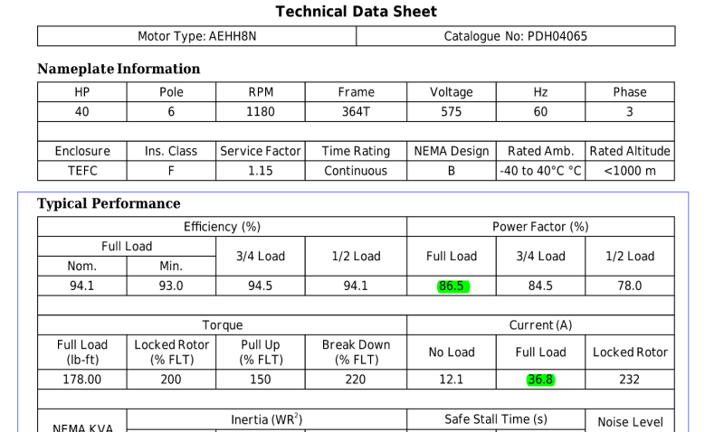

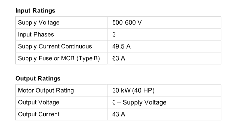

After reviewing the shop drawing, I noticed that the specification lists two full-load currents. Please refer to the attached file for clarification. I am a little confused about which one I should consider it.
43 Amps is the maximum VFD current.
The motor full load current is 36.8 Amps
40 HP, 575 Volts, 94% efficiency and 86.5% Power Factor correlates with 36.8 Amps Full Load Current.

I am astonished that you do not seem to know how to read a simple table.
The header row of the bigger number clearly says "Power factor (%)"
The lower one clearly says "Current (A)"
So there is only one FLA, not two.

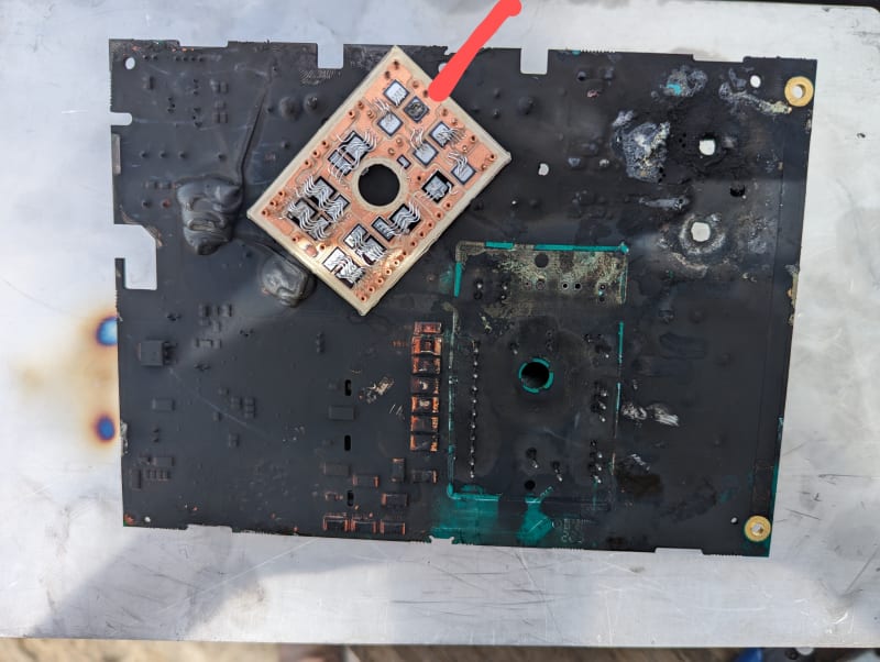

I spoke with the contractor, who informed me that the VFD had broken into pieces with a loud bang on the floor. He remembered that the fan operated correctly for a few months. He also mentioned that he does not have any information regarding your concern. I plan to visit the site next week to gather more information and site photos.

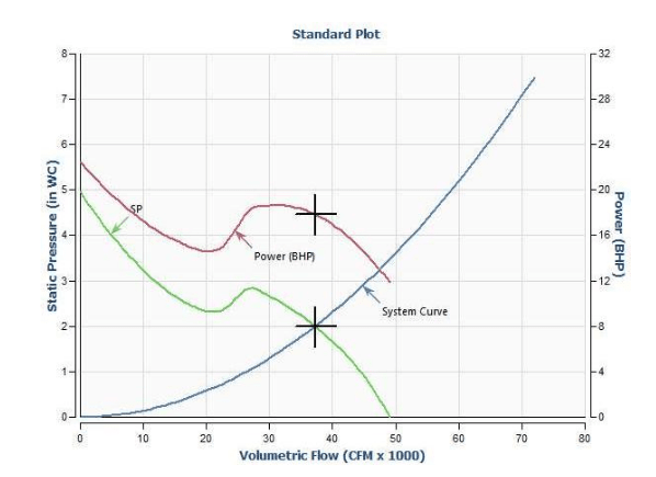

The load is the exhaust fan which was given clips earlier. I am not quite sure if the operation was done properly as per fan curve. Attached is the fan curve.
A fan will put extended stress on any starting system to overcome inertia. I'm sure you have taken this into account. Lots of mention of the fan motor and the VSD but nothing about the cable between them and in particular the length of that cable. Have you got a choke involved?

"Broken into pieces with a loud bang" - What ???
Sounds like complete destruction and huge internal shorting, not "damage when starting".
And if it was working OK before then this is a simple failure of a unit which should be in its warranty period so sweep up the bits and return them to the vendor and demand another one or your money back...
Loud bangs and VFDs are never an application or programming issue. Never. This is either a component failure issue or an EXTREME voltage event. The only thing that can suffer a “Rapid Unplanned Disassembly Event” (RUDE) like that inside of a VFD are the capacitors. Capacitors can fail for a number of reasons, but rarely go RUDE unless it is something really big. I would be looking at the power quality at this site with an eye toward big events. If it has happened more than once, that’s even worse!

Another thing though, and please, I know it seems far fetched but I HAVE experienced this more than once and it does foment a RUDE event…. Did someone accidentally connect the line to the load terminals and vice versa?
I wouldn't say only the capacitors. I just had a VFD blow up starting with a diode failure that led to a sustained arc flash resulting in lots of catastrophic damage.
