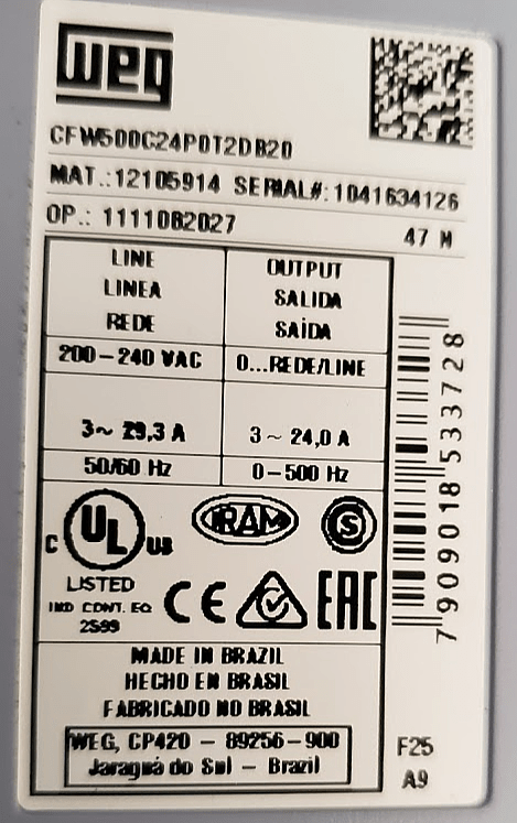

Do note that the WEG drives are finicky about being sized correctly to the loads. Mine wouldn't do a lot of things, just flat refusing, due to a bad motor size to drive size mismatch. The sensors in the drive are apparently optimized for the rated motor size.
My drives are WEG500 not the WEG700 I thought they were though the 500 series does the same torque control. Oddly the manuals describe it differently.
Mine are:
Current looks a bit ow for you.
