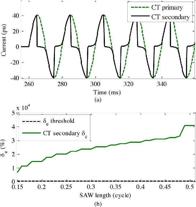

I assume it would very difficult to distinguish the effects of reactor saturation on a highly distorted waveform. If you measured the voltage across a reactor going into saturation due to just the 60 Hz component, I think the last portion of each half cycle the waveform would be a flatish line such as:

I see. So there is still some reactance, but suddenly a small fraction of the original reactance once the current hits a certain magnitude?

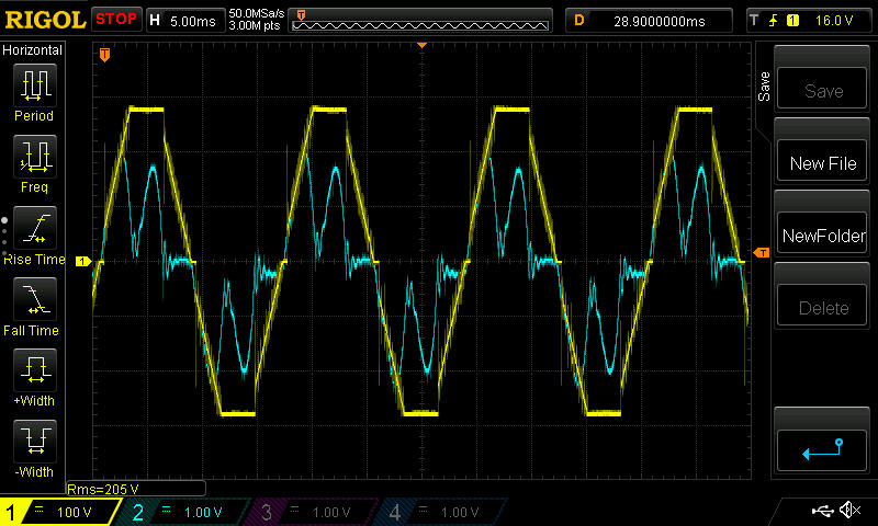

The waveform images are very useful, and that makes sense. I do have a 3-phase line reactor on a pump in an R&D lab where the voltage between any two phases at the reactor output (but not across the reactor) looks like a triangle wave on rise and fall, and a square wave at the top and bottom (see image). I was curious about what causes this and if this is an indicator of saturation.
What kind of power supply is used here? And what overvoltage protection devices?
Seems there is voltage limiting (clipping) not reactor saturation.
The output voltage of a reactor, or any other VFD filter, won't be a sine wave. I'm not sure if what you have is correct, but I would suspect it's fine. VFD reactor manufacturers know the load, so the reactor can be designed to match.
