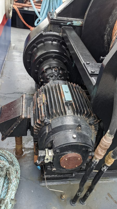

I am having an issue with a winch motor operated by VFD. During powered inhaul the motor is tripping on overspeed. The max frequency and overspeed trips are set correctly. I don't see how it's possible for the VFD to drive the motor at excessive speed. Is it possible for the shaft encoder to output a faulty speed signal that is high?

This is a TENV motor driving an epicyclic gear turning a sprocket in an enclosed chaincaee.
The winches with captains have shaft brakes so I can pull the brake housing cover to expose the shaft. No capstain on this one. This winch has a rotary coupling for the pneumatic clutch. I think that's my only access though that may be after the clutch.

The encoder is directly mounted to motor shaft, no clutch involved.
Ahah! Got to the boat today. There is a cover on the encoder end. Now if I only had a tach.
