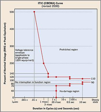

In contrast with other international codes, the NEC only provides a suggested total voltage drop to be not more than 5%. (Exceeding this value is not recommended but is no technical a code violation). In the US the ANSI C84.1 established in 1954, is the official utilization voltage regulation that includes not only the maximum but also the minimum allowable operational voltage. Most recently, the CBMA/ITIC provides a guide for utilization voltage for computer and electronic equipment.
Regarding your VD calculation, the most important aspect is to provide a utilization voltage at the load within the window recommended by the manufacturer, usually, ±5% of the nameplate rated voltage. It should be noted that at the transformer output, the voltage can be regulated with the LTC to maintain the source voltage in the optima operating range.
Cuky - you stated what I was hinting at - utilization voltage limits are the only thing the load cares about. So the as designed voltage drop needs to limit the total drop to the utilization window, regardless of what delivers the power to the point of utilization. And of course depending on transformer selection and sizing with respect to everything else, they can help or hurt.
