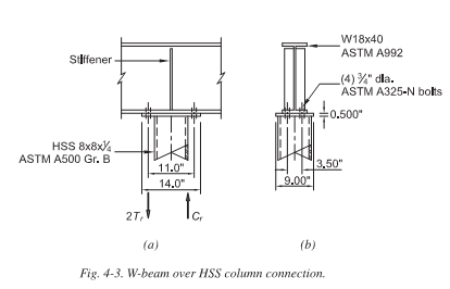

I was wondering if there were any design aids for setting a steel beam on a steel post. I would think this should be possible but there is nothing provided by AISC (At least that I could find). I have also searched in here to see if someone mentioned it but I couldn't find anything. My thinking was to have the beam rest on a plate welded to an hss column and add a stiffener at the end of the beam if needed.
I have a 38 foot W21x121 Beam that has a extended end plate to a W14x90. This is for a residential house and it's kind of bulky and would rather use a hss column if possible. This is used as a moment frame as well as a header for a 32 foot opening.

I've often connected W Sections to an HSS with a thick top plate to transfer the moment... not a real big problem as long as you have the real estate for the connection.
strucbells:
I have seen this as well as the design Guide 24 which has a very good explanations and example of how this works. My only issue is that my column would be at the end condition and not an interior support. I dont see anything which mentions an end support and wasn't sure if I could carry over the same methodologies or not.
Also the reason for the giant beam is only for deflection. The beam isn't even close to failing but there is a 32' sliding glass door system and I'm just worried about it binding. Not really a mega mansion but its on the water so they want a huge view of the water.

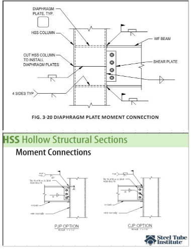

Two examples for your information. Check STI for guidance.

I could be wrong. But, I think the OP is talking about a connection that looks a little more like the following (where the column terminates just below the beam rather than continuing past). Though he also said the beam ends at this connection too. So, your connection could still work with the column continuing up a bit with a cap plate at the TOS location of the beam flange.

I took his "my only issue" comment about the column being at the end condition to mean that the connection I showed is slightly different than he wanted to use because the one I showed had a continuous beam. But, the concepts are the same.
Note: I would not use the connection I showed as a SMRF or IMF for seismic. But, I would think it would be fine for moment resistance of gravity loads.
Not missing much... not common, but I've done it... Thick, designed cap plate and beam plate with an end plate welded to the HSS and beam plate, and two 'wing' plates at the front edge of the beam plate to keep the HSS wall from collapsing. Welds transfer the moment from the HSS to the beam plate and bolts transfer the moment to the cap plate... I'll see if I can dig up a CAD dwg...
Since it needs to be part of a moment frame - I would recommend framing the beam into the side of the column and using a moment connection. We commonly do the detail that Dik mentioned with big strap plate from the top of beam to the top of the column and then a angle seat at the bottom flange to take the moment.
I like your detail, Josh... use it often and I like the web stiffener terminating an inch or so below the top flange... I still see a lot of projects where they fill the web space (except for the fillets)... easier to fit, less material and weld... it's a win-win.

Also, I think the reference towards STI (Steel Tube Institute) is excellent. They give a lot of good support to engineers. Lastly, I think a variation on the connections you showed connections would have worked fine as well. Arguably they could be a little better if we're concerned about connection rigidity.
