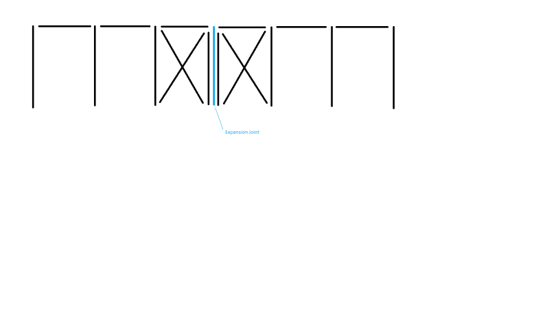

Warehouse roof framed with steel joists and joist girders, long span of roof diaphragm is 520'. Considering expansion joint. I see details with two rows of columns that transfer shear but how do you deal with diaphragm chord forces?

I'd be curious to hear other's experiences, but I've typically opted to make an expansion joint also into a seismic separation joint. I can then skip the diaphragm continuity details and make the two sections of building completely separate laterally.
You should see in DG 7 there is a reference to Expansion Joints in Buildings: Tech Report 65 (1974). I believe that has some temperature information, and a methodology for establishing it. Some locations are included in an appendix, IIRC.
Not a design problem I've faced personally, but its seems to me that you'd break the diaphragm chord at the expansion joint and provide lateral force resisting elements on either side.
When I make an expansion joint I actually separate the building into two separate structures. I am in the process now on another building (690' in length) and I have two rows of columns and 2 braces located at the joint. I have heard of having roof members with slip connections but never attempted it...... if I did, I would still end up with a brace along this line to avoid the situation you are ending up with.
SteelPE - Thats what I think is appropriate/prudent/best strategy...but braces down that line are not expected and will not be received well.
I see SDI DDM has an example that appears it takes the chord force (that would exist) back into the wall line below...example could benefit from some additional discussion...looking for another example/reference/guidance or confirmation from others on this approach
Well, Then you can put a moment frame along that line......... but I wouldn't want to be the one who has to design it.
You can also put the braces a line or two away from the joint, and cantilever the diaphragm beyond the last frame and over to the joint. Should be fairly easy to make work, depending on your building's aspect ratio.

engjg - are we still on topic with your question? It seemed to me from your original post that you were good to to go on everything parallel to the expansion joint (using the SDI example for transferring shear across the joint), but needed help with the diaphragm chord that is perpendicular to the joint - right? Or did I screw that up?
The chord can't cross the expansion joint, but the diaphragm can (in one direction) with careful detailing. You'll have to break your deck and transfer the shear through some sort of a connection that is rigid in the direction of shear transfer but slips in the direction of the EJ.

Can you not design the expansion joint to only allow slip in the direction perpendicular to the joint, thus creating continuity for diaphragm forces normal to the sidewall of the building? Then you just need to ensure you provide a load path for chord forces (arising from wind normal to sidewall) down to the foundation on each side of the expansion joint at each sidewall.
The joint can then slip perpendicular to the sidewall and all your chord forces are accounted for. All bracing remains along the perimeter. In this case it doesn't matter if your LFRS is shear walls or x-bracing or moment frames.
I am thinking something similar to this detail:

Alternatively, introduce a double column line at the expansion joint and design stiff moment frames for each side. You just need to ensure that the diaphragm is more flexible than the frame lines.
This way for design you have two separate 4 sided boxes.
