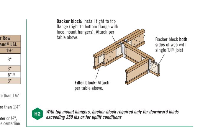

Has anyone ever used facemount hangers instead of top flange hangers for the member
haning into the I joist packout? Why can I not find that (facemount) hanger detail
on any of their literature?
probably because a face mounted hanger on those type of joists is a bad idea. would put a vertical tensile stress in the joint between the web and cap members, which the joist is likely not designed for.

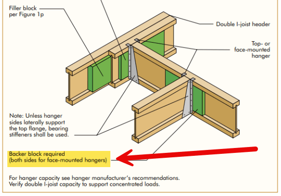

My TJI Catalog shows a face mount hanger...
Facemount hangers are absolutely fine on i-joist, but some additional considerations are required. Your filler/backer block must sit flush with the flanges. Additionally, the connection of the filler/backer block to the joist web must be considered to match the reaction capacity required out of the hanger. That is to say, you will need to run double shear calcs with nails attaching the filler/backer block to the joist web to ensure enough nails are provided to make this assembly act as 'one', which then allows the facemount hanger to attach to this assembly and makes the assembly act as a composite piece, rather than 3 seperate shear planes. Nothing terribly complex, just want to ensure the connection assumptions for the hanger to the joist are valid.
This is not the expected behavior of this assembly type, and would only occur if the connection between the filler/backer and joist web is insufficient to support the hanger, and instead, the filler/backer is bearing directly onto the bottom flange. That's the only situation that would cause web route pull away, and can be avoided by using a sufficient connection schedule between the filler/backer and joist web.
Face mount hangers are part of the detail the OP posted. Using face mount hangers for IJ's is not that unusual provided you understand the limitations. Note the 1280lb limit on the OP's detail.

But if I had to, I think I'd be mostly ok with doing the following:
[ol 1]
[li]Use solid blocking along both sides of the web with the face of the blocking flush or slightly proud of the side of the top and bottom chords.[/li]
[li]Design the blocking to web connection for the load from the supported member.[/li]
[li]Leave a small gap between the bottom of the blocking and the top of the bottom chord to ensure that load from the blocking isn't pushing down on the bottom chord.[/li]
[/ol]
The torsion acting on the I-joist from either a face or top mount connection doesn't seem great, but I suppose the manufacturers aren't too worried about it or else they wouldn't allow this type of connection.
