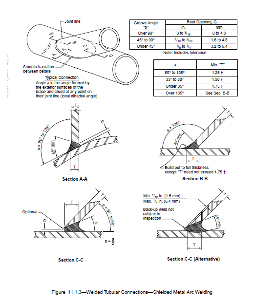

I will suggest you to look API RECOMMENDED PRACTICE 2A-WSD ..The same reference states ;
and 11.1.3 , pls find below picture copied and pasted from API RECOMMENDED PRACTICE 2A-WSD ..

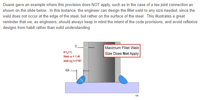

If you use the tube wall thickness and set it to be the maximum leg of the fillet weld, then I am struggling to understand your dilemma because fillet welds fail in shear across the throat of the weld, so that in my opinion would be the weakest point given that the weld electrode has similar strength properties to the steel tube.
I prefer the left hand side option with all around fillet/bevel weld. All add a square plate on the anchor bar, then weld the tube on this/near side and other/far side.
desertfox... I'm welding BAR 1/2 to 0.14 thick tube and cannot get HSS 1.66 in thick enough wall section. I'm not concerned about the weld failing; I suspect the tube wall will fail before the weld.

Dear Mr DIK, for that reason i proposed you to look API RECOMMENDED PRACTICE 2A-WSD Recommended Practice for Planning, Designing and Constructing Fixed Offshore Platforms. IMO, a very good reference for tubular structures and joints.
