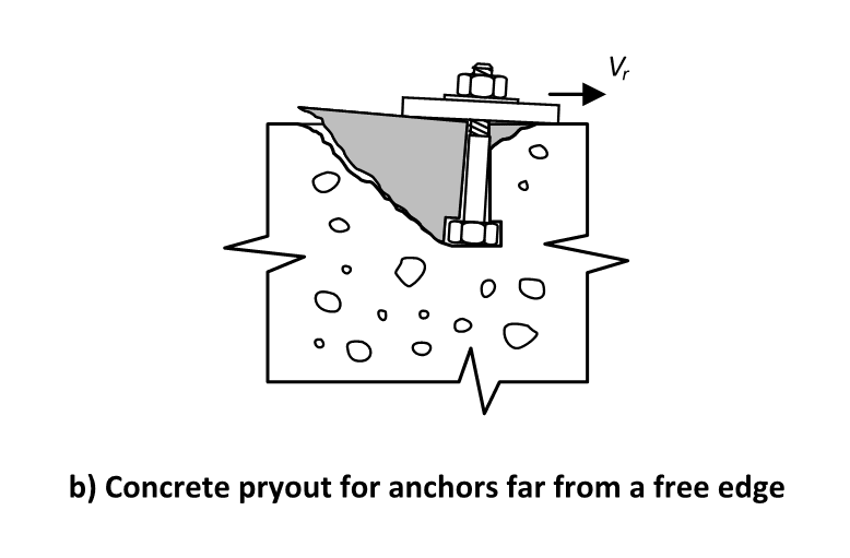

No, I don't believe that it is. Here's what I think that I know of the history of this, in chronological order.
1) Back in the Flintstone era, we used to assume that some multiple of the anchor was effective in "bearing". 6d or 8d or whatever. Turns out that was complete nonsense. And even if it were not complete nonsense, there were still a bunch of other failure modes that we needed to be checking anyhow.
2) In the early days of modern anchorage theory, you would see shear friction checks done in the literature as you've suggested. The idea, I believe, was to replace the "bearing area" concept as the means of initially getting the shear force out of the plate and into the concrete mass. Unfortunately the shear friction business does not account for the impact of edge distances etc so you still needed a bunch of other failure mode checks as well.
3) We seem to have landed on the failure mode shown below as being the means of initially getting the shear force out of the plate and into the concrete mass. This is really what the "bearing area" concept should have been all along. You never really do generate a true bearing stress failure at any reasonable anchor length. Rather, you get this baby pry out mechanism. I don't recall seeing a shear friction check in the literature in over a decade. But, then, I've not been searching for it either.
4) Testing suggests that DBA capacities are always higher than equivalent diameter HCA capacities. The ratio is relatively constant at about 1.2 for large edge distances and increases for lower edge distances.
5) From experience, I know that the failure mode shown below often does produce a higher capacity than does shear friction. Are there some anchorage arrangements where shear friction is the winner? Maybe very densely spaced studs in low strength concrete? I really don't know. What I do know is that concrete to steel shear friction is thought to be a true "dowel mechanism" of shear resistance to a significant degree. And, in my mind, "dowel resistance" is precisely what the failure mode shown below is speaking to. Consequently, I'd be pretty hesitant to go with the shear friction number even if it did represent an improvement over the baby pry out failure mode shown below.

For very large edge distances you will generally shear off fully developed rebar. So check that. Check the welds too, as often they will fail prior to the bar itself.
Agent666 said:
With rebar anchors fully developed and lapped with wall reinforcement like efFeb has stated you're not going to get pryout though?
I disagree. With the anchors developed and anchored, you're not going to get a pry out failure of the entire anchor group. I believe that the pry out failure of individual anchors -- what I've been calling baby pry out -- remains on the table as a potential failure mode.
Agent666 said:
You should be checking a steel failure limit state for the anchors themselves, whether studs or rebar.
I agree completely assuming that "steel failure limit state" means things like anchor shear failure, weld failure etc. Hopefully we are all on the same page in recognizing that those failure modes alone are not sufficient for us to have claimed to have moved the shear load into the body of the concrete mass however. For that, we need one of the following in addition to the steel failure checks, depending on one's believe system:
1) Shear friction or;
2) Individual anchor pry out.
