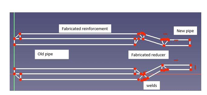

Assuming that the old pipeline is corroded and after measuring the thicknesses, there is a feeling that it can still be used. Under such situation I propose the following for additional safety(for review by experts)
Basically, a fabricated reinforcement is shown for strengthening of existing pipe at weld location. This reinforcement can be welded to the new pipe by using a fabricated transition piece.
A sample piece can be cut from the existing pipe to be fabricated like the above, and testing can be done to determine its strength and durability.

And Goutam: I appreciate the suggestion but if I did that, I think I'd be laughed back to the office.
