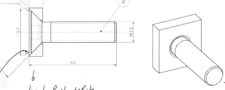

Can someone send us an example of the need for welding on bolt 8.8 ?
Regards
Here's a common assembly, rails with multiple bolts and locator pins (in hard steel), used on airplanes.
The ISO view is a detail, and doesn't show the entire part.
Regards
In my experience, it's a site maintenance manager who managed to keep a badly designed (or overtly abused) machine in operation longer by welding together some fasteners. Then they apply that requirement to all machinery.
Also in my experience, it's impossible to predict what will happen when you weld on a bolt. Will it crack? Will the bolt lose preload? Will the bolt gain preload and stretch? Will the base components distort and lose connection quality? Nobody knows because it's unpredictable.
David
