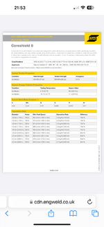

I’ve sent the report to ESAB , Lincoln and SWP for ideas but no one will commit. I’ve been told the O2 saturation is low at room temp but upon welding O2 absorption will combine with C and create CO causing porosity which cannot happen. I can only do the work as correctly as possible, but a couple of tech guys are saying there is a rod produced in 7018 with extra flux that should be ok as 7018 is made up of Rimming Steel. Looking further I’ve found some flux core which contains 0.51% AL, enclosed specs, I’d be grateful of any input, cheers, Nik
Possible ESAB flux cores wire?

Self shielded flux cored wires (i.e. innershield) typically contain high amounts of aluminum to counteract the expected atmospheric contamination from oxygen that occurs during the welding process. I'm not sure if they contain enough aluminum to also counteract high oxygen from the base metal, but they might be worth looking at.
If you use/abuse a self shielded flux cored wire with shielding gas, it would increase the aluminum available to scavenge the oxygen from the rimmed steel, but I doubt any self shielded wire manufacturer would recommend that. Another welding consumable you might look into are ones designed for single passes, or that claim to be good for welding over rusty steel (which I'd never recommend- but some people still do it anyway), because they can also contain higher amounts of deoxidizing elements.

Now if you can find a filler similar to E6012 that contains Al (or Ti or some combination of multiple deoxidizers) then you might be on the right track.
I've used E6012 for repairs on a pedestrian bridge built from rimmed steel before 1905, but it was of much superior quality than the steel in the photo.
