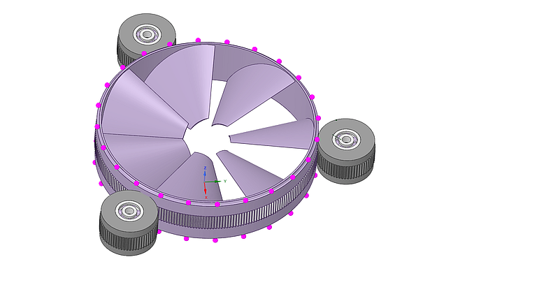

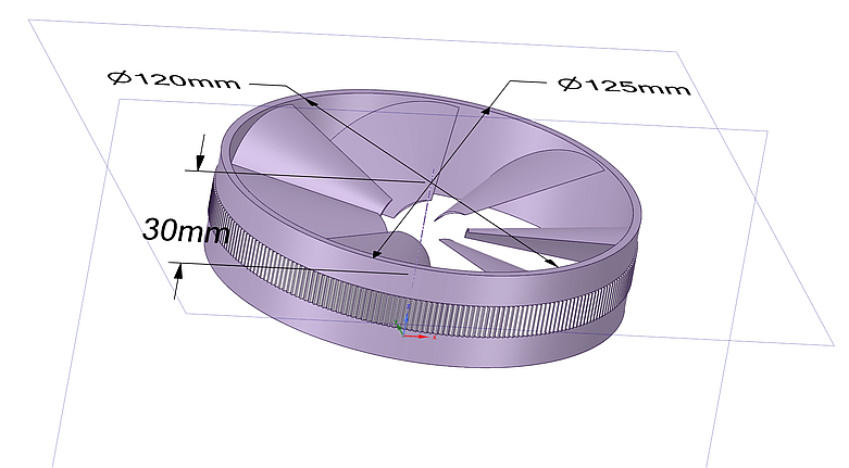

What methods are possible for "bearings" for a 120mm diameter x 50mm rim-driven, HUBLESS rotor?
Mass: ~128.5g
RPM: 2000-3000
Forces:
Radial: its own (well-balanced) mass x angular velocity.
Axial: ~500g in one direction.
Note: Besides the ludicrous costs, stuff like this is excluded because of weight.
Looking for ideas, possibilities...
Here you go:
The rotor is driven via the external gear teeth.
It need to be supported by some external arrangment to bear rotation and axial forces in one direction.
Ideas?

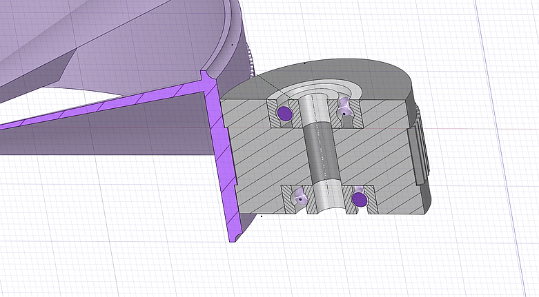

A couple of ideas I've already had:
The pink balls are loose Delrin 3mm balls. Needs a cage or low-friction spacers of some kind.
The 3 'gear bearings' @ 120° have (say) 5x16x5 minature deep groove bearings top and bottom.
Two are fixed position, 1 spring loaded or adjustable. (1 drives the rotor).
The flat cylinders above and below the gearteeth are pitch circle diameter.
The teeth are half inset half proud:

3DDave:"Why not include the inner race as part of the rotor and create your own outer race? Pack in some ball bearings; the loads for that size are very low; 6-8 mm balls will be more than enough."
If I went for a full compliment ~66 per race, of 6mm steel balls, it would weight roughly 0.25kg, which would kill the weight allowance for batteries.
Using a sparse arrangement -- (say) 18/race -- requires a cage or spacers and its difficult to see how to make that work mechanically.
So, how fast will those be rotating?
Don't use steel or use fewer with a generous separator. There are other ball bearing materials. And it's too bad you didn't mention the weight problem earlier.
