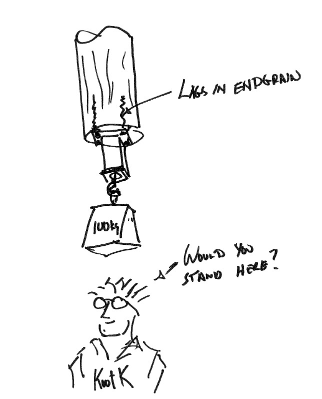

what is the best connection for this? round timber pile to steel beam? 8
delagina
Sep 18, 2010
1,008
I can't figure out the best connection to do this.
if the timber pile was square, I could have used seat angle at the bottom of the beam.
but I prefer to use the more common round timber pile.
is there a round seat angle?
I could also install anchor bolts on top of the pile and bottom flange of the beam?
If you're switching to steel beams instead of timber framing why not switch to H piles and save some headache?
How about making a pile cap with two plates in a T and knifing one into the pile with throughbolts. I've seen similar connections with round glulams.

I generally avoid end grain dowel connections too. But, then it's usually somebody trying to stick a 1/2" lag in the end of a 2X. Here, I was imagining a long, large diameter galvanized lag in the clean cut end of a big old log. It doesn't generate the same negative visceral reaction in me for some reason. I'll try to imagine the piling 50 years in the future with checks and fungus growing from the top.
Nice... Is it really that off putting though? I'd stand underneath it in the rain for 15 minutes if there were a case of beer on the line.
The last time that I pulled this stunt (same load) it was much more dire. Teguci's definitely got me with regard to artwork quality however.

Kootk, sorry for the hiatus on your end grain question. The reduction in capacity factors are for perfectly fine wood, the end grain will be partially rotten in a few years. If you drill holes that allow water to penetrate it deeper, well then rot will occur even faster. I will say this, as you are rarely ever wrong on here, your design will have adequate and surplus load at first but the longevity will get you, the top of the pile will get weaker quicker and you will first loose your lateral capacity and will soon loose bearing capacity.
bolting through the sides with notched seats will allow the most compromised area to be lower in the wood and will allow more wood to protect the connection. The bolts will bend, they will slide but they will hold up.
I work with a few 'attraction' owners, we have completely disallowed lag screws from being used on any of our projects... I have seen the effects of the connection in 5,10,20,30 years of service each time i look at their older buildings... So i may be biased due to what i have seen in a short period working with them.
