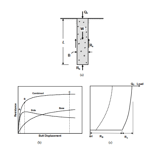

Is there any guidance/reference to determine when end bearing of H-Pile should be ignored? Recently I found some driven H-pile design that ignored end bearing at all though the soil is dense sand. As a result the pile length becomes higher. Appreciate if you share your experience. Thanks

MTNClimber - I'm looking at factors that could influence point bearing in dense sand:
Cross sectional area of an HP is really small, say, 15.5 in2 (0.108 ft2) for an HP 12x53.
Not only is the area small, the geometry of the pile tip makes it a poor "footing"... for HP 12x53, essentially 36" x 0.435" ≈ 15.5 in2.
In dense sand, a properly driven HP is going to have a lot of surface area to develop skin friction. Relatively little load is going to even reach the pile tip. Section 3 of the Bethlehem book talks about how even end-bearing HP driven to rock fail before the tip is fully loaded (unintended skin friction at work).
As a bridge contractor, we would extract temporary HP when finished. To do this (in dense sand), the best way was to drive the the pile a few inches deeper to break skin friction. Then pulling the pile was easier (but not always a piece-of-cake). To me, this just confirms that (in dense sand) point bearing, while probably not zero, is minimal compared to skin friction.
In total, I consider the pile tip bearing of an HP in dense sand to be just "noise".

We install the things by smashing them into the ground with a big hammer so I suppose that logic is consistent with never relying on end bearing
All we're really trying to do is end up at point A (or make sure if we are wrong we end up at B and not C).

PDA and static load tests with strain gauges data that I’ve witnessed and reviewed have shown tip resistance in sands can provide with substantial addition to the capacity. Even if the end bearing is worth 15% of the total capacity, that reduction in pile length can save a lot of money on projects with 100’s piles.
