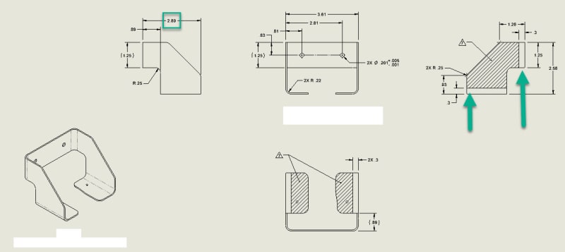

Where in 14.5 does it state that we don't need to show the length in both the left and right views; that we assume it's the same unless otherwise noted?
In the attached image, I've shown both sides because one side needs to be masked and the other does not.
Just like we assume two edges are 90deg if it looks like it, don't we also assume the sides are the same unless otherwise specified?
I'd never seen or heard a complaint about this in 20+ years in the industry so I'm perplexed at the comment I received but also not certain how to argue my case from 14.5.
