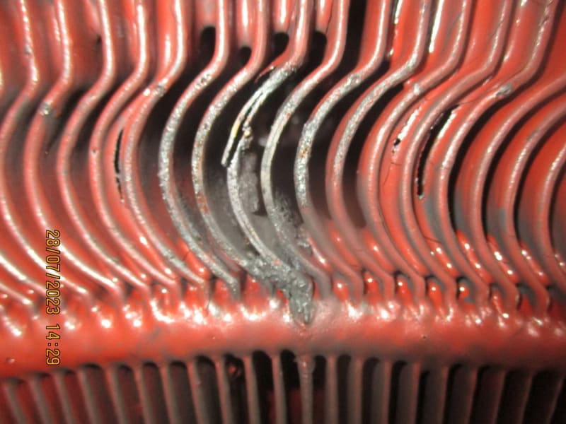

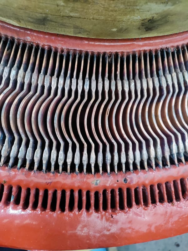

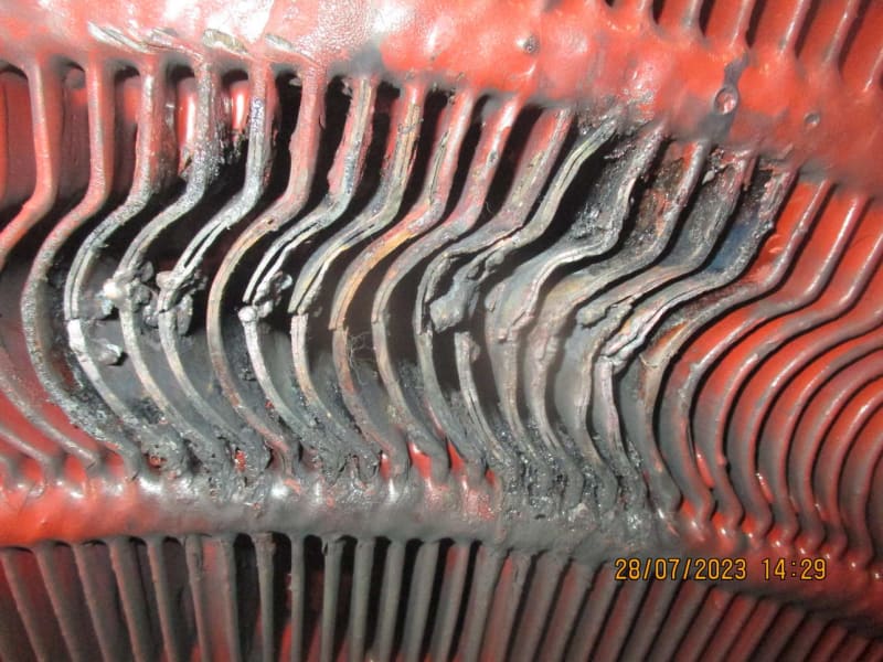

Weird failure mode for a metal. Why am I seeing what looks like delaminations?
And why is one area grey? Local heat damage?
Looks more like an electrical failure, possibly from cooling spaces blocked with paint.

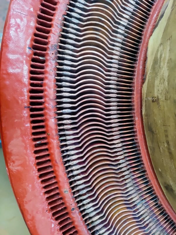

Is that also a groove? Orthographic pictures make for optical illusions.
How is there force applied to the middle?
The copper cracked in those areas while the current was flowing resulting in flashover. The force was rotational stress?
Muthu
No, that's not structural...not unless you have debris in the housing that impacted the commutator. Was that brazed in section a repair, or original manufacturing? Could be a low quality copper sheet or sheets laminated together. One comes apart while it's rotating, flashover, and boom - local damage to several. But I think your original question is unrelated.
