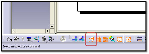

Look in the Tools + Options Drafting settings and turn off the "Half Dimension" option.
The gray dimensions are from the Dimension Analysis being turned on. You can turn it off with Tools + Options, or click on the little icon in the bottom menu:
