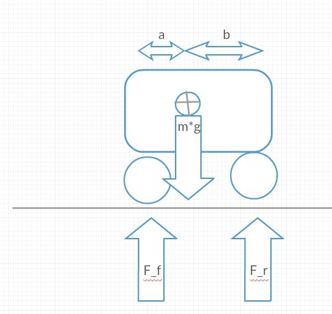

Sta bars change the left to right distribution of Fz, but they do not change the fore aft distribution. if they did one end of the car would rise up . Draw a free body disgram in side view.

Greg, I'm surprised you seem to believe "The" or "A" free body diagram can decide this question.
Of all the attitudes the suspension of a car on road or track can take for any condition of loading, side force and instantaneous ride height, the car would seek the lowest energy configuration at any instant, but this would be described by a family of free body diagrams. Vehicle dynamics software can provide this. If you have access to that I can be easily convinced if you would kindly post the curves for ride height and other interesting parameters.
Yes i spend every day running adams, or measuring cars on the track, or working things out with a pencil and paper. You are the one making the ludicrous proposition, it's up to you to show how it could work. A side view fbd of a car with weight and 2 axles shown is sufficient to demonstrate that in the absence of longitudinal acceleration there is no weight transfer.
Cheers
Greg Locock
obvioulsy m*g=F_f+F_r
F_f=b/(a+b)*m*g
Otherwise there must be accelerations in the plane of the diagram.
