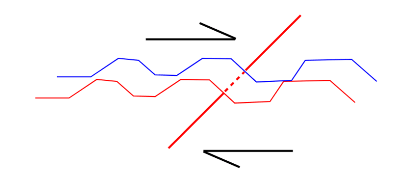

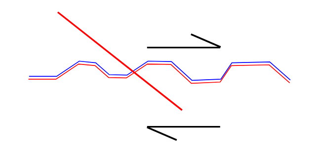

Here's a physical explanation that makes more sense to me. Imagine you have a surface with aggregate interlock and a bar oriented opposite of the shear friction:
Once the shear is applies, the interlocked aggregate will try to slide over each other therefore moving out and toward the direction of shear:
That is bending the bar, not really stretching it. Keep in mind that my image is greatly exaggerated - if you let the wall slide enough, it would stretch, but not until it got into the geometrically nonlinear range)

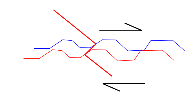

If it was oriented the other way, the bar would stretch along its axis:

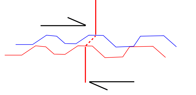

And with a perpendicular bar, you would have a combination of bending across its axis (along the sliding interface) and stretching along its axis (perpendicular to the sliding interface):
There may be some amount of resistance from dowel action, but there isn't that classic shear friction bar stretch

Compression in the rebar means the rebar is pushing back at the concrete on either side of the joint. I.E. its making a tendency to separate the joint. Whereas if tension is developed in the rebar due to the shear, then the rebar is restraining the crack from opening.
Well put. E_steel = 29,000 ksi. E_concrete = ~4,000 ksi. So I'd imagine what the code writers were envisioning was that the compression in the steel would be reducing the effective normal force across the joint which is required for aggregate interlock. Not to say aggregate interlock goes away completely but I guess they don't recognize any equations that would capture this effect.
