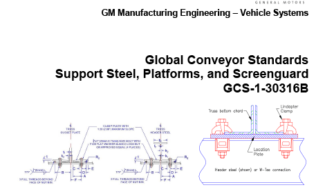

Wide Flange Clamp Design
Not sure what you are trying to accomplish, but personally I would consider a product like those from Lindapter.
Sorry should've added more detail, but basically there is a going to be an attachment below the clamp that will be adding a tension load. I know all about Lindapters but field crews prefer this method and it is more cost effective.

Has anyone had any experience designing a clamp like this before?
Yes.
It is pretty straight forward for the bolts and the clamp. You have a load point (end of plate), a pivot point the round bar and the bolt in between. Don't have the clamp too long or you can end up with larger prying forces.
If the loads are high then you'll need to check the beam flange which is more complicated, I'd look at monorail guidance for suitable checks.
I cannot find any mention of the GM conveyor standards in the public domain. Sorry that I cannot be more helpful -

@mountaineers19 did you find any useful references to complete the design?
I am having to design a similar connection. An added challenge to my situation is that the hanging load comes with a stainless steel plate. I am thinking of using galvanized bolts for clamping and a painted top clamping plate with the square bar at the outer edge. I will need to provide an insulating gasket between the square bar and bolt washer in contact with the stainless steel plate.
My factored hanging load is about 3kips.
I would suggest reviewing the ESR report for Lindapter clamps, since it outlines the design steps used for code compliance: There is a simple interaction equation for combined tension and shear. The tension and shear capacities in the ESR are based on testing, but I imagine conservative values could be derived analytically.
I would choose to do an FEA if you have capability to.
