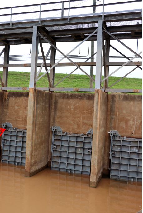

The winch will open and close flap gates for maintenance. We have an existing steel platform that we are going to modify for the winch mounts.

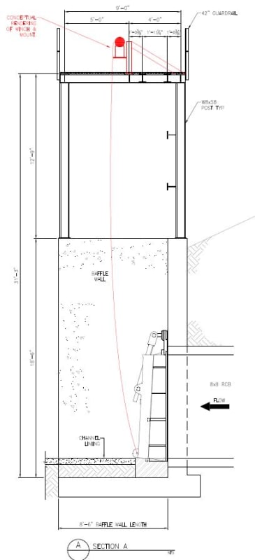

Below is a cross section of what I'm working with.

Yes, We will lift up the 8'x8' gates and then workers will drive a small bobcat through the box culverts to clean out any muck & debris.
We have discussed a back-up restraint, but have not come to a decision. Perhaps a secondary chain or wire rope that can back up the winch.
I'm familiar with 3 other locations and they rely on the winch only to hold the gates open for maintenance.

In your X-section, where is the gate hinged, that doesn’t show up on the drwg., and what are the hinged linkages on each side of the gate for? The X-sec. does not seem to match the photo, why not, and which is right? You don’t need a 10k winch to lift a 3.3k load, you are piling a FoS on top of another FoS. I agree with JStephen…, “I'd be kind of surprised if there was a single value of factor of safety used.” and I like his analogy “It's kind of like asking what the factor of safety of an automobile is.” The winch people already have a FoS in the design of their own equip., for their confidence in their own design, so it will already lift much more than their rated load without failing. Ask the winch manuf’er. about this, you are not talking about lifting double/triple the rated load 10 times a day. Do you really clean those 8x8 box culverts out “once a month lifting” (28APR21, 19:32)? This relates to the duty cycle per day or year, and the life of that equip. If you want some FoS for your own overall design and mech./elec. equip. package, for proof of deign to the client, consider testing the system to (125%)(3.3k). You will find that ‘125% of the rated load/lifted load’ as a final testing value, in a number of places in the ASME B30 stds., this is a fairly common proof testing loading for lifting equip, when structural or mech. equip. are the limiting factors. The 85% of lifted load number for stability of a crane has been around for a long time, but doesn’t really apply here.
Depending upon the exact situation, I would look at buying 2 or 3 winches about 2 or 3 ton cap’y. Your 5t (10k) winch is really expensive overkill. I would put these winches on little railcars, on tracks, on longitudinal beams, up on your existing platform/deck. These can be moved to track stops over each gate, since you are not likely working on all gates at once. I would put an elec. power supply stand btwn. two (every other) gates, to serve those two gates with power and control. This type of system will likely save your client in first cost, and in maintenance of excess equip. The max. lifting load would appear to be during the initial opening phase, so position this track system for best advantage at that phase of the work. This same railcar/track/winch system might be used for gate maintenance and replacement lifting, so consider that as a potential future use, and price advantage of your offering. That same winch could run a second wire rope drum, with an unloaded safety cable, attached to the same lifting shackle on gate. This wire rope would just be pulled up to the deck as the gate opened, and then through a fixed loop at its top end, it would be tied off to a fixed spot on the deck or the railcar. Put a hinged cover box over the winch to keep it out of the weather when not in use, but let it breath.
