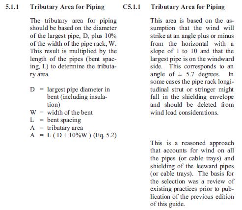

I have a 30 ft. x 30 ft. trellis with perimeter HSS beams and two intermediate HSS or I-beams to break the rafters into 10 ft. spans. For wind perp. to the rafters, does anyone have any info on the wind shading from rafter to rafter? I found an old post from 2006 that states anything within 4d spacing is considered shaded. Not references were cited, however.

Not finding anything too encouraging in the archives. The responses range from wind on first and last rafter to using a 30% shading factor on each member.
Let's face it, if trellis's actually had that much effective wind area, they would be failing all over the place. I have yet to see this happen.
If I do 30% shading, the wind load is pretty un-manageable as this thing is huge.
Anyone else got something?
I recall a while back someone mentioning how eurocode addressed this. Essentially they consider the wind load applied at a 10degree inclination and the resulting load on each rafter is whatever the projected area on each member is. Seems a bit more manageable than 30% rule.
ASCE's "Wind Loads for Petrochemical and other Industrial Facilities" addresses this in the case of wind loading on pipe racks, where you have multiple pipes side by side with a transverse wind. It is essentially what dold alluded to above where the wind can strike at an angle from horizontal. ASCE uses a slope of 1 to 10 (5.7 degrees), this is accounted for by using the largest pipe diameter plus 10% of the pipe rack width when calculating the tributary area. See snippet below from ASCE for further explanation/clarification.
