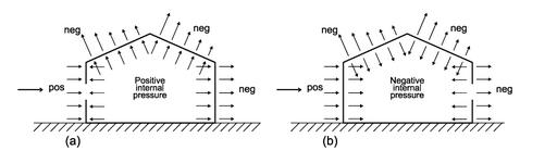

how should I apply wind pressure on internal wall according to eurocode 1991 ? considering the building is enclosed or in other words no dominant face is present

- Figure 5.1 Gives the Pressure on surfaces as per wind direction and position of openings,

many thanks for your response but I was meaning an internal wall inside the building that is not subject to any kind of external pressure
in ASCE-7 we apply 0.24 kn/m2 my question is about EC 1998 how does it handle it ? do we for instance combine (+0.2) and (-0.3) ?

Pls look 7.2.9 Internal pressure clauses 3,4,5
