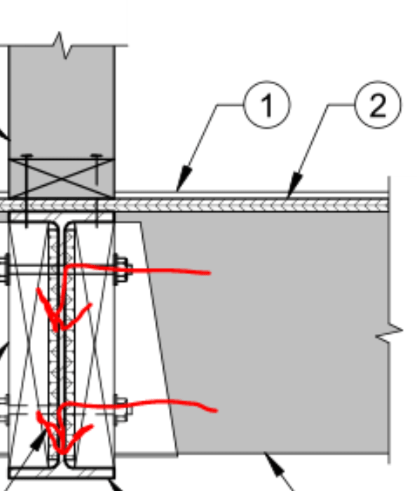

We designed a new steel beam to replace a wall. The existing joists are to be re-attached to the steel beam per detail 5 which shows 2x infill blocking. After installing the steel beam and it's wood section infill, the Contractor has sent an RFI stating that the ends of the existing joists are too short to attach as shown in our detail. I'm guessing they trimmed the joists too short after removing the wall. I believe the joists are 2x10@16"O.C. and the beam is a W10x19.
Here are some of my thoughts on a solution:
[ol 1]
[li]Remove all of the thru bolts space at 16 in on center to remove the 2x blocking and re-install thru bolts with new 3x blocking. And make sure joists are trimmed exactly to fit. This kinda seems like an overkill since this occurs for about 60 foot of the steel beam support.[/li]
[li]Sister in joists to bridge the gap. This definitely seems like an overkill since you would probably have to sister 3 or 4 feet of the joists with a whole bunch of fasteners I imagine.[/li]
[li]Install some sort of ledger to support bottom of joists, but I'm not sure how this would look or how it would attach to our steel beam?[/li]
[/ol]
How would you re-attach ends of wood joists that are short of their support member like this?

Looks like the beam is loaded from one side. Adding another member to the side will increase the eccentricity and it may rotate. I would sister back as far as you need to for the shear and moment.
Probably only 24" would do.

Looks like the beam is loaded from one side. Adding another member to the side will increase the eccentricity and it may rotate. I would sister back as far as you need to for the shear and moment. Probably only 24" would do.
That's a good point, the torsion on the beam is something I haven't considered. Not sure if the original designer even considered it. But since it is wood framed floor framing into a steel beam, I don't think there would be a whole lot of torsion on it. Sistering may be the way since it's probably going to be the cheapest. I need to read up on how to design sistered splices effectively and optimized. Any design sources or example suggestions that you usually use?

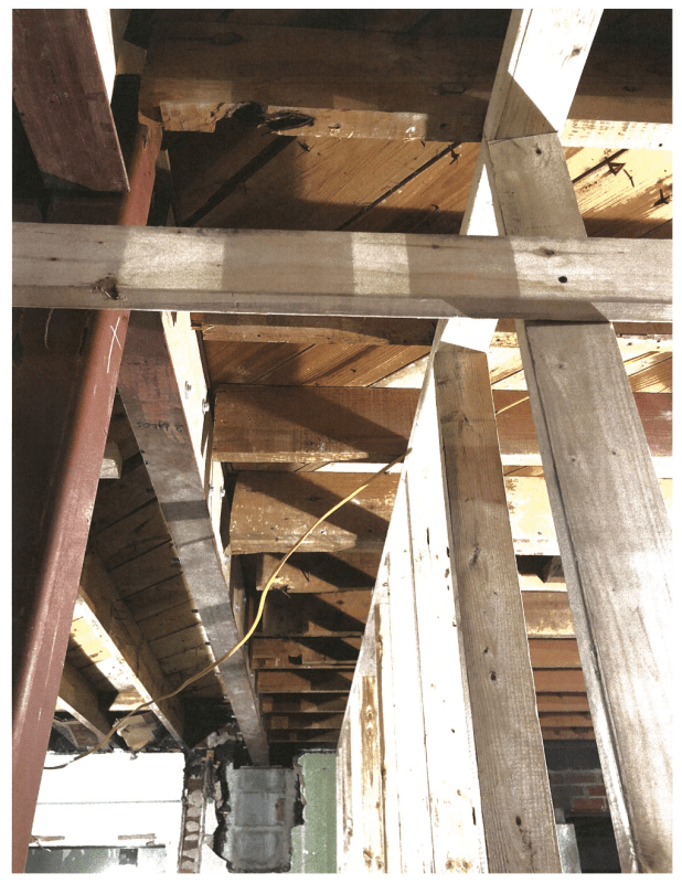

Based on my conversation with the Contractor the joists are actually 3/4" to 2-3/4" short of the support - not one inch! Below is what I've sent out to our client (the Architect). Let me know what you guys think. I'll keep you posted on additional information.
My understanding is that the majority of the joists have been cut too short by the Contractor and that is why they are now short of the beam support. Because of this, detail 5/S-500 cannot be installed as shown. There is no easy solution to re-support the ends of these short joists. Some of the options we have thought of include the following:

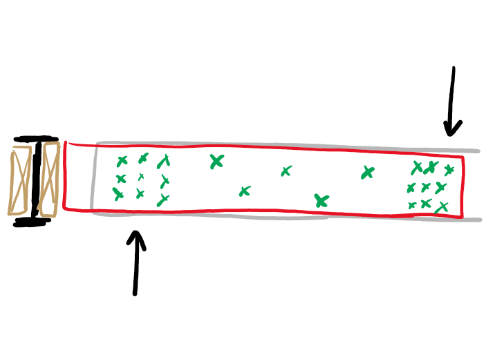

If it were me, I would just cut the joists back to a consistent length, and ledger a new block to the web filler on the steel beam. With the thickness of the ledger to match the short cut length of the joists. Now you can hanger off the ledger and problem solved.
Similar questions have come up before on these forums, and put me firmly in the camp of not trusting nor relying on the development of a moment connection in wood to try and splice a short member and make it longer. Always keep in mind that load follows the stiffest path, and mechanical connectors are nearly always less stiff than the wood itself, so it's unlikely that the moment connection will engage prior to local member failing, unless the mechanical connection is a long epoxied length or some other exotic connection that develops sufficient stiffness.
Are you certain the existing condition wasn't something like this:
I've only seen it done this way a handful of times but the framing seemed to be laid out this way to try and alleviate the deflection differential between adjacent spanning joist and bearing point.

I doubt you would need to go back that far to sister. 4 ft. and some poly subfloor adhesive and you will be fine. I don't agree with ChorasDen on this. I would not go route #2. The blocking will never be installed tight enough to do any good.

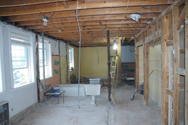

Ahh, I missed the lower wall on the right of the photo when I first opened this post. What is the purpose of this wall? You mentioned in the OP that the original wall supporting the joists has been removed by the contractor. Celt83 may be onto something with that detail.
I would guess that wall is the temporary support of the joists while they install the beam.
I tend to agree with XR250 on this one. The amount of moment that the sistered splice would need to transfer is relatively small, I don't see how any significant rotations/deformations could develop due to fastener slip and cause major issues before that moment is resisted (assuming appropriate qty/size fasteners are used at each end of the splice).
We discussed this in our office and it's not going to work. They will essentially run into the same problem again. They won't be able to properly install the ledger to fit because the ends of the joists would be in the way. It's hard to visualize the constructability issue but the image below might help. Unless we detach the steel beam, install the correct size wood ledger, and then put the beam back where it's supposed to be.
That wall is most likely temporary support holding the existing joists up.

The first two photos below shows the conditions prior to removal of the walls. These are at two different locations but they have the same issues. You can see the joists extend over the interior wall line in both photos. So they definitely cut the joists too short.
The last photo shows a better view of the current condition of the short joists after installing the new steel beam. I believe the Contractor didn't want us to see all this additional information but I had to squeeze it out of them. Take a look at the first photo they gave me in my first post in this thread compared to the photo below. They were trying to tell me that all of the existing joists already needed extensions. Meanwhile when you zoom back a little you see only 1 or 2 had existing extensions and the rest just have been cut short. Also in my phone call conversations they are trying to avoid admitting this at all costs.

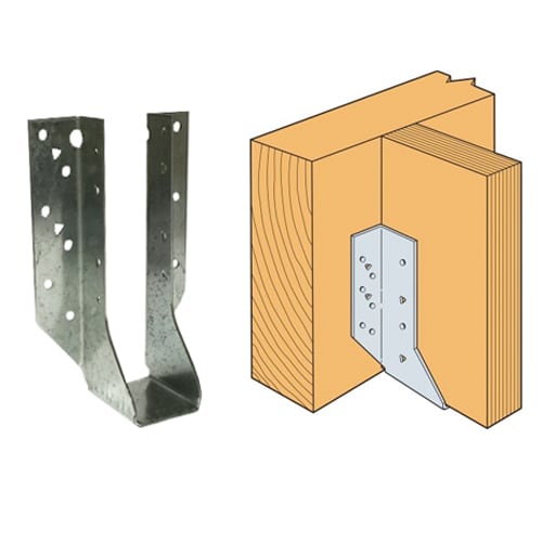

Just my guess, have you tried any Simpson ties to counter the gap or ask them to provide if any custom-made ties are available? Still, there is an eccentricity issue that we need to deal with

@Veer007 this is the connection we have shown in the detail in my first post of this thread. Simpson states a maximum of 1/8" gap. We have gaps ranging from 3/4" to 2-3/4". If this vonnection could work, I wouldn't be too worried about the torsion since most of the load is transfered to the beam web via the 2 through bolts. But if we were to bear the joists on a plate welded to the bottom flange, then I'd say the torsion is more of a concern.
I would be very worried about torsion. Stick with sistering. Also, specify that the existing joists be cut back enough to allow the new hangers to be installed without interfering with the seat.

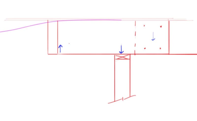

See below for the load path that someone in my office claims will occur and that's why they are not as worried about torsion. If there were no through bolts and the joists were bearing directly on the edge of the bottom flange I would definitely agree that there is torsion to worry about. Not too sure what to think with the thru-bolts in place myself though. I just tried drawing a free body diagram and it seems like the through bolts would just push the blocking on the one side down and the blocking on the other side up. Essentially resulting in torsion again, globally.
