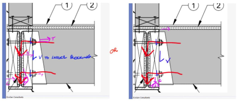

From the hip I see these two loads paths depending on if you designed the blocking as a ledger or not and assuming the hanger is face mounted:
Per your left sketch, I think the torsion in the beam would be (Joist Reaction) x (Distance from joist end to beam web).
Per your right sketch, assuming that the blocking distributes the load evenly onto bottom flange, the torsion would be (Joist Reaction) x (Distance from blocking center to beam web).
Either way, now I don't see how the existence of the through bolts would reduce the total torsion induced on the beam in any way. Not sure how my coworker dismissed the torsion because of the through bolts.

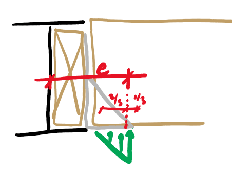

Top flange hangers would produce more of a problem, because you have to locate them with almost perfect accuracy before installing the beam. Yikes. Even with joists framing in on both sides, this is a very common and doable detail. I've used it several times. You just have to have a decent contractor who doesn't entrust this task to the new guy with a dull recip saw.
And yeah...the torsion is very much there. I would argue the torsion is Reaction x Distance from the shear center of the beam to the centroid of the triangular, elastic bearing pressure between the joist and the hanger seat. At the very least e would be from shear center of beam to the center line of the reaction on the hanger.

I really don't see how this top flange hanger solution thing is supposed to work. Or how it would give you any better flexibility. The hanger can't sit off of the edge of the top flange (or nailer plate if you use one). Take a look at the Hanger Installation Notes in the Simpson Catalog. You'll see that the hanger needs to be tight up to the edge of the carrying member. You can't let it hang out in space and fill the back with shims or blocking. Now you can fasten structural blocking to the beam to fill the gap, but you can do that with a face mount hanger, too. You just have to pay attention to the torsion in the beam, because that beam looks very small.
And even if you have a nailer on top of the beam...you have to drive nailers down into that nailer plate to fasten the top flange hanger. Unless you put the hangers on before the beam is in place, you can't do that in a retrofit application. You have a contractor who can't operate a chalk line and cut joists straight. Do you trust them to place 20 joist hangers with 1/32" accuracy on the ground?

Don't do the plate. They'll have to do a series of overhead plug welds on the joist side. First things first, check your beam for torsion at the current eccentricity? If it does, then the simple solution is to fill the gap between the joist and the filler blocks with a solid piece of lumber and screw it into the web filler. Then use a face mount on that. Proportion everything so it fits, and keep track of each little eccentric connection. You may want to put something like a Simpson Pre-Bent strap every few feet on the bottom of the beam and fastened to joists to help restrain the inevitable twist in the beam (even if it is strong enough to resist the torsion, it will still twist).
