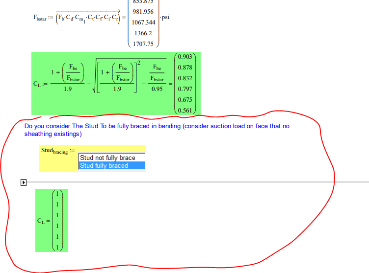

I tried to account for this in the mathcad sheet that I had posted in the thread that celt83 linked.
We had one engineer in our office who was pretty adamant about this being an option.
S&T
sticksandtriangles,
While your consideration of lateral restraint for the calculation of bending capacity is important, I was specifically referencing a NDS2015 provision that pertains to column-buckling and the determination of CP, the column stability factor. If you're already aware of this distinction, please ignore me.
