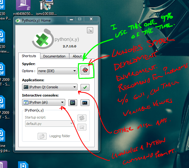

so with python-xy installed you can double click any of the .py files to run the scripts, if the file name has "gui" in it's name you'll get a graphical interface otherwise if it doesn't take any user inputs a command prompt window will open and then close for these ones open them in Spyder, see attached screenshot, and you can run them and see realtime variable results.
I relied a lot on youtube/google but got started with two books Automate the Boring the Stuff with Python and Python for Kids (despite the name is a excellent beginner book and even gets into some GUI stuff)
Quick animated gif showing basic spyder use: gif
(there's a portion that gets cut off in the gif, I am clicking on the quit option in the context menu that pops up)

To open it via command prompt in Windows:
Open start menu
Enter the following:
Code:
cmd
In the command prompt type the following:
Code:
cd C:\Python\[i]folder where you put the python scripts[/i]
For me I would type; cd C:\Python\Scripts
Then type:
Code:
python wood_stud_wall_gui.py

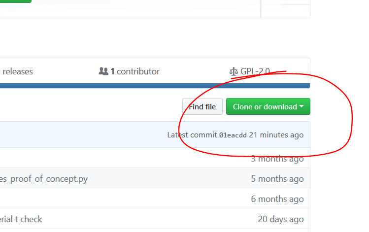

For now, I'd really like to simply open the program and poke around a little bit and compare with my own work. Unfortunately, I'm still struggling simply to open this darn thing. I have the spyder environment open, but I'm not sure where to go next. Do I copy the code and paste it into the editor, save as a .py file, and hit run? Or should I be able to download your github file and double-click it? TME's response seems to suggest to me that I should be able to download the github file, save it somewhere, and use the windows command prompt to run the program/script... but I can't find a "download" button for your github file.
Celt:
I finally got it up and running. Thanks for your help! TME's post made me realize that I needed to create a Github account first before I could see/use the download button he pointed out.

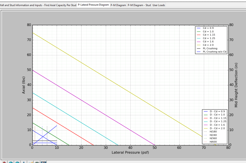

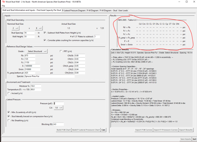

so i finally bit the bullet as well and downloaded python xy and I am trying to run the program.
I have an issue in that it does not allow me to press the build "P-M chart" and the "P-Lateral Pressure Chart" after clicking the "calc button". see below, they are greyed out even after hitting calc:
Also my p-m curve looks a little funny, I am guessing they are related.
Any thoughts, am I missing something?
S&T
yeah the P-M curves are pre-built as just diagonal lines until they get calculated to save on some drawing time.
I'm not gettting the same thing on my end with your inputs, is anything getting written out in the command prompt window when you hit the calc button?
Edit: I just reuploaded the py files, try grabbing them, though I didn't see anything obvious as off with the ones that were out there.
Edit2: the STICKS version enables all the buttons, let me know if after you click the calc button and try to generate the curves if you get any messages in the command prompt window
Open Source Structural Applications:
think I got it the wood_class_file wasn't the latest one and was missing the leb definition, if you scroll your calc window the Cp portion errored out.
should be fixed now
